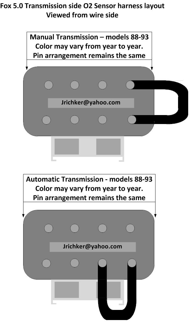

Tomorrow I will rent a fuel pressure tester and do some more investigating but I would like to mention this, I found that my o2 sensor harness had been rubbing up against the header and burned at least one of the wires down to the conductor. Could this cause an issue like this? Like maybe the car only runs decent in open loop then once it hits closed loop it gets thrown for a curve becuase the o2 isnt functioning correctly? Just spitballing, thanks for the input.
The O2 sensor is critical to closed loop engine performance. Replace it with the same transmission specific harness that is already in the car.
O2 Sensor harness interchange and modification
Originally Posted by 302EFI
Revised 16-Oct-2011 to add O2 sensor harness warnings
The wires for the 02's and low oil did not change throughout the years, they are all in the same place.
The main ones you need to worry about are (on the harness end (ECU) that plugs into the 02 plug) is:
\- 1. Lightblue / yellow
- 2. White / Purple
- 3. Purple / Yellow
The White/Purple & Purple/Yellow gets looped for a automatic ECU
The Purple/Yellow & Lightblue/Yellow for a manual ECU
Not all wires are shown for clarity and simplicity
See http://forums.corral.net/forums/gen...manual-auto-differences-year-differences.html for more O2 sensor wiring harness info
Basic premise to use with transmission swaps:
Only run a 5 speed trans O2 harness with an A9L. Do not run an Auto O2 sensor harness with an A9L. Doing so will damage the computer’s internal signal ground.
Only run an Auto trans O2 sensor harness with an A9P in a car that has an Auto trans. Using a 5 speed trans O2 sensor harness with an Auto trans will cause no crank problems.
See http://www.stangnet.com/mustang-forums/749974-computer-issue.html#post7490537 for Joel5.0’s fix to the computer internal signal ground.
The 4 cylinder O2 harness uses 4 wire O2 sensors. It probably won’t work correctly without modifying it.

The O2 harness you mentioned is the prime suspect in this case ; either replace it or repair it. Keep in mind that the O2 sensor harness is transmission specific.

Okay, harness has been replaced with a brand new one and the problem persists. If you unplug the o2 sensor harness the car will be able to run just fine just with a very high idle. Does that mean it has to be the o2 sensors?
There are 2 different flavors of O2 sensor harnesses: 5 speed transmission.and automatic transmission. The O2 sensor harness MUST match the transmission type that is in the car.
