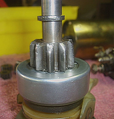

update 4-30-11
pulled the starter today, and this is what I found
What would cause this to happen? All the teeth have similar damage. Can I just replace the gear?
