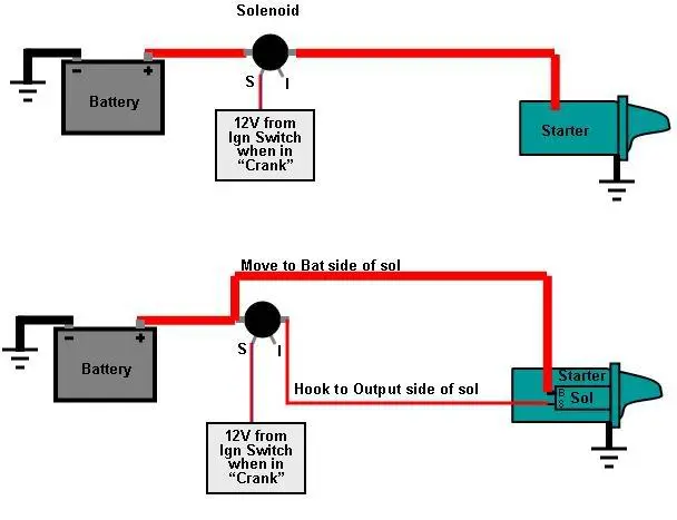

S steel1212 Active Member Jun 24, 2004 1,180 0 36 Frankfort, Ky Jul 10, 2009 #1 Jul 10, 2009 #1 Anybody got one just so I make sure I don't fry the new starter I have coming?
Tim65GT Active Member Feb 24, 2004 1,149 2 39 West Texas Jul 10, 2009 #2 Jul 10, 2009 #2 I think from a previous post you said you have a mini-starter, right? The hookup is different than stock. You actually don't need a full size solenoid, but here is a diagram of both before and after a mini starter swap:
S steel1212 Active Member Jun 24, 2004 1,180 0 36 Frankfort, Ky Jul 10, 2009 #3 Jul 10, 2009 #3 That is how I have it....good.
