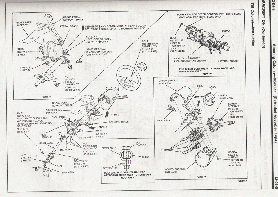

The steering wheel shat fits in a steel tube formed to fit the shape of the shaft. If wear on the tube and shaft gets excessive, you can have problems like what you are seeing.

Im trying to remember, but on a tilt column there should be another joint in the steering shaft that thebbolts will back off causing an issue. The was a thread a few years back about this. I'll try and find it. Try looking in the upper column fornloose joints or brackets.
