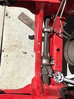

I am wanting to change my manual steering rack to a power rack, however all the units I see on the internet have the bolts that go thru a rubber bushing. Mine has rubber bushings that wrap around the steel tube and have a "U" shaped clamp that bolts it to the sub-frame. Is there any hope for me? Am I stuck with manual steering?

Could you take a picture of the rack in your car?
Per request, see below. Appreciate your help.

supposedly it's out of a 74 mustang, it is grafted into the front of my 36 gmc truck I am building. I'll go and get the numbers that are stamped on the crossmember later today.

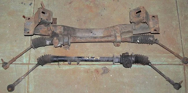

I've never seen a Mustang II rack that looked like that. It resembles the rack from a Capri (1969-1977 era) more than anything else I've seen. (The upper one in the picture is for a RHD model, the lower one is for the the LHD model).
Mustang II racks are all held in by two or three bolts through the crossmember (my factory power rack had three, my replacement manual rack had two).

here are the #'s on the crossmember: 12 8 72 I assume is the date, PARISH, 032B-6210010-A Which is the part number for the crossmember I guess. hope this helps to identify what I have :)
Is there a number on the rack?
That looks like it's gonna be a hell of a scavenger hunt. The only thing I can come up with, which probably won't be of much help, is this chart that i found through a Google search. http://my.cardone.com/techdocs/PT 22-0005.pdf
But as stated, it doesn't look like any II r&p that I've seen. And the date code on your cross member, if that is indeed the date code, predates Mustang IIs. Pintos were made at that time though, but I'm not too familiar with a Pinto r&p mount to know enough to say that's what it is. I'd imagine they're the same mounting style as the II since the II is based on the Pinto.... :shrug:
