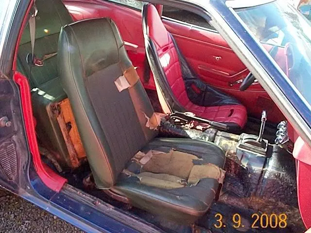

I'm putting in a set of Pinto hi-back bucket seats. They look just like the 70-73 Mustang Hi-backs, except a little narrower, fitting between the trans tunnel and rocker area better. Looks like the MII seat tracks and stuff might bolt right on. They don't recline, but they do fold forward so you could climb into the back.
The Fox seat swap seems to be the more popular one. I just never cared for the looks of a newer seat in an older interior.

Here's a pic I took yesterday. Gave me a good excuse to pull the II out of it's coccoon and take it for a hot lap around the block.
The seats are in dire need for re-upholstery but i think you can get the jist of what they would look like. Oh- and they also bolted right in, no mods what so ever. Will have to change the seat tracks on the passenger Pinto seat as it was on fixed mounts, they didn't slide forward or backward. Looks like the II tracks will bolt right up.
