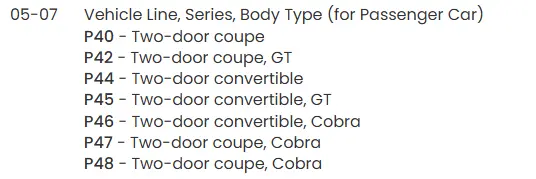

You want to check digits 5 6 and 7 in the VIN. P44, P45 and P46 are the convertibles.
