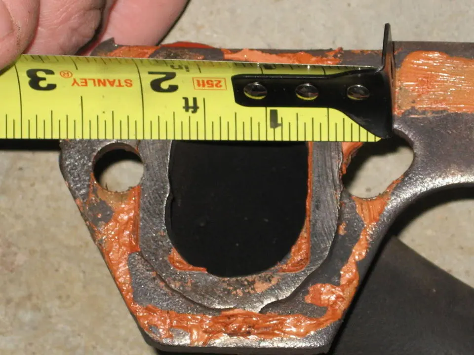

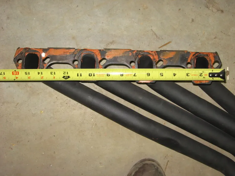

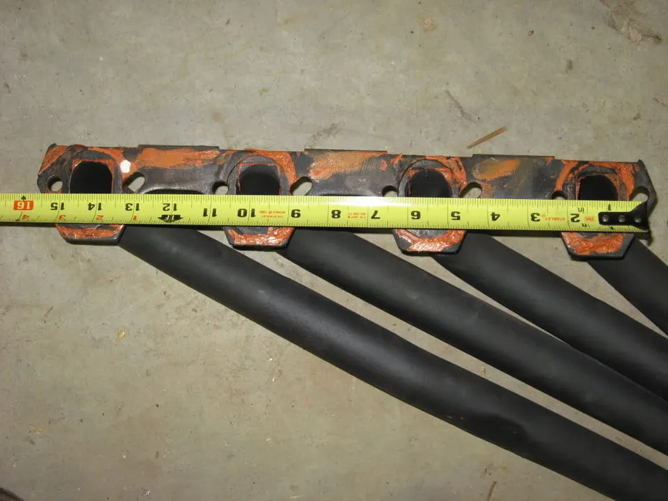

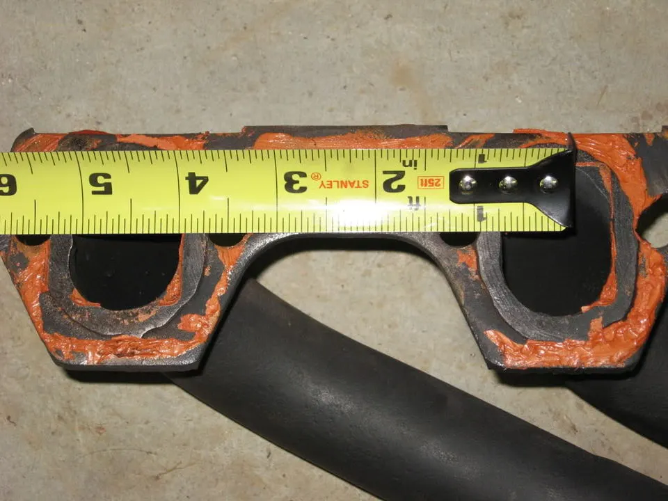

if someone doesn't beat me to it, I'll give you some measurements. I've got my headers off now (cause i need new ones to fit the AOD) and I'll do some measurements.
port width, and inside to inside along with total length.
awesome....thank you....one other measurement while you are it...my particular heads have a diagonal bolt pattern...just curious as to whether its the same as a SBF...though the port shape is entirely different...so maybe a bolt spacing(center to center) and offset(distance between the two holes horizontally) measurement too
and PICTURES!
alright, here ya go!
the port spacing is 4.5" on the nuts from center to center.
the bolt spacing is 2.25" from center to center.
outside bolt to outside bolt is 15.25" center to center.
and the total width is 16"
if you need any other measurements...(that you CAN't tell from the pics :) ) let me know!
:flag:
awesome, thank you very much, unfortunately it wont work....the port spacing is 4" on the 4.6L, which will be a inch off for the #1 and #4(or #5 and #8) ....so much for that idea...unless I redo the entire port side of the header and by that point I may as well build my own from scratch....as for exhaust manifolds, the only ones that will fit(driver's side anyway) are Marauder manifolds...not exactly easy to come by...or cheap when you do
