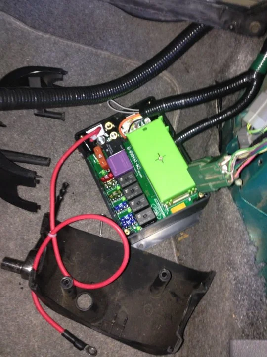

you can it takes some work the Florida 5.0 stuff makes it easy View: https://vimeo.com/121142017
. The video attached is the one I did
Reactions: Boosted92LX and 19RED90GT

That harness up the right side was made to look like a factory harness . It passes through the original ecm grommet where the light portion of the control pack is mounted in the car .

I'm excited for you man it was fun and they run great your gonna love it . To get that connector through the fire wall I had to completely de pin and re pin on the other side of it

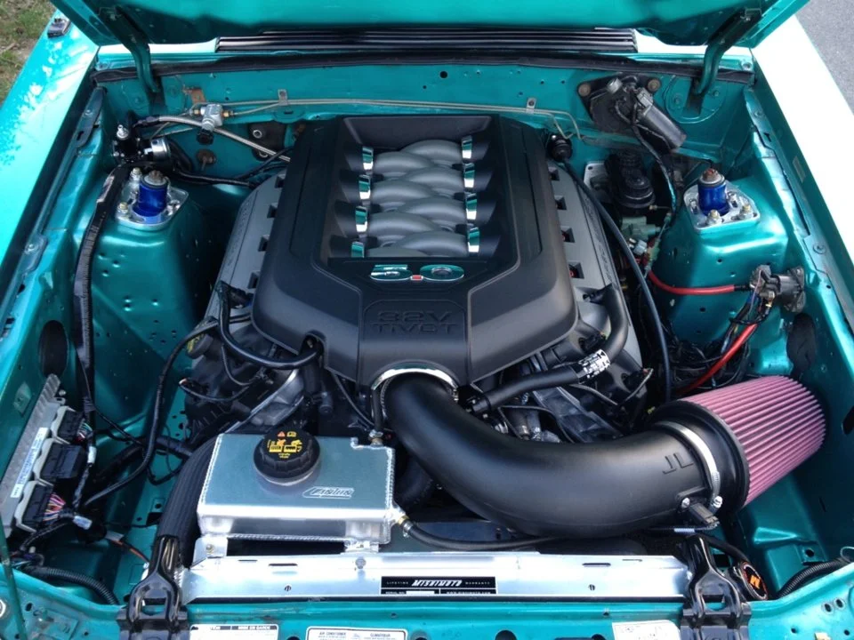

@TOOLOW91 what JLT cai is that?
The one they sell for a reg coyote car I think my buddy got it from LMR OR AM

89oem said:
Nice! any mods or just plug and play?
I am getting a tune...
Just the JLT and the swap long tubes - you need a tune with the CAI . car made 435 to the tire on big daddy Dwaynes Dyno

Can you please post some pics of that calypso green car?
