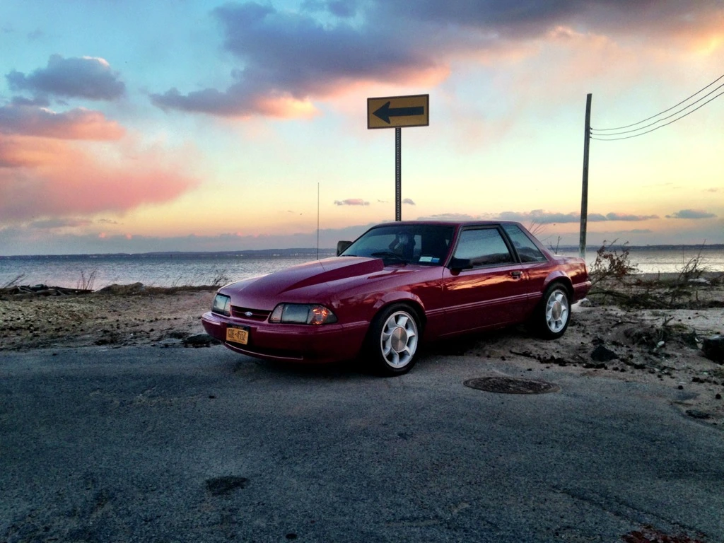

I am on 17x8.5 cobras and eibach pro kit with tockico blues , tires scrub the plastic inner up front every once in a while but I love it the ride , stance , and feel

my front also has no lower ISo and the rear have poly ISo's

That is a sweet looking coupe
