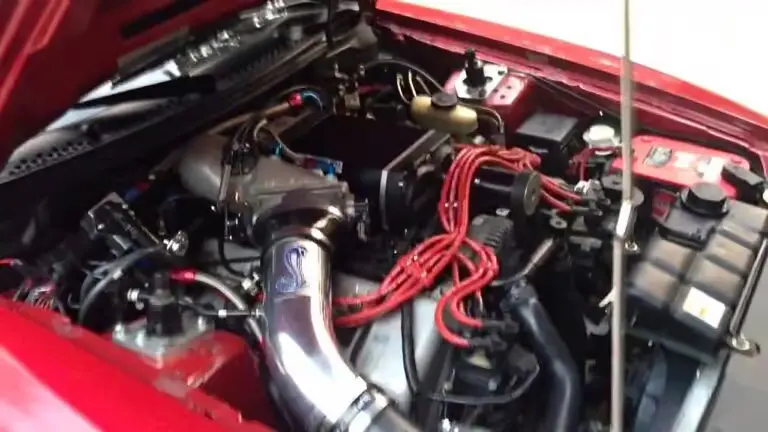

Last week I bought this 98 Cobra from a guy in Florida off the SVTPerformance.com forum. Below are the details of the car and some pics that he took for his ad. I know of only two issues with it so far, first the clutch cable was incorrectly installed into the firewall adjuster so I need to remove the rubber piece off the cable and fix that issue, and it seems to have a power steering fluid leak that I think is coming from the rack but I haven't had a chance to locate it for certain just yet and I need to power wash the undercarriage. Other than that so far it's just a really clean Cobra with most of the mods being on the suspension side. I plan to take it to some local Auto X events and just use it as a fun car until my 1992 Coupe build is finished.

Griggs Racing torque arm/panhard bar, lower control arms, subframe connectors, k member, a-arms, solid aluminum rack bushings, bumpsteer kit, Griggs adjustable coil overs/Koni adjustable shocks/struts.
Under hood is Maximum Motorsports adjustable caster/camber plates and strut tower brace.
Braided stainless brake lines on front brakes.
Aluminum drive shaft
TA aluminum rear differential cover/girdle
Steeda TriAx short throw shifter
Adjustable clutch quadrant/firewall adjuster/cable
Exhaust consists of oem manifolds with Bassani mid pipe and Flowmaster catback.
