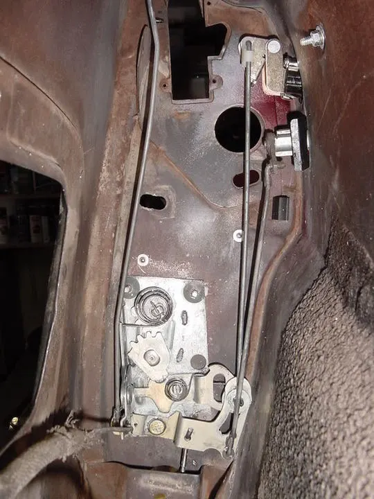

Maybe this pic will help:
If you can reach in and make sure the lever with the long slot is up (lock/unlock rod), then move the other lever behind it up (catch release).
