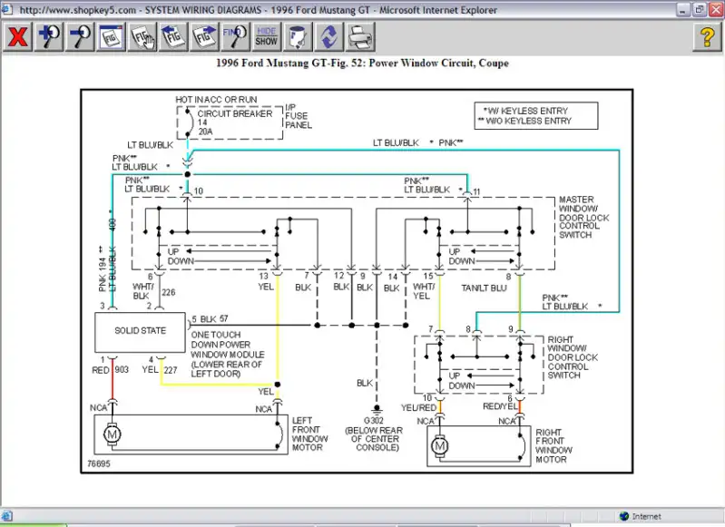

On a more serious note:
They all look like they feed from a common ground. If that ground is bad then nothing would work. Correct me if I'm wrong. Here's the wiring diagram.
