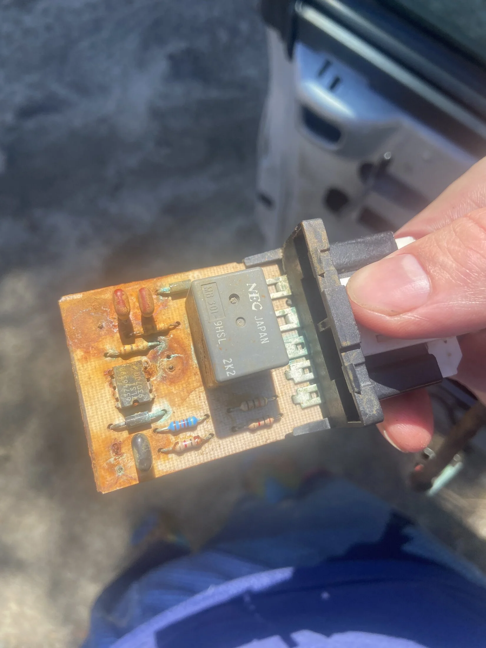

Found the problem. I guess it does have a control module in the door. It was hanging in the bottom of the door and had gotten water in it ( multiple times). There was 3 capacitors that fell off and I'm guessing were making contact to make the window go down... Cleaned it out and my windows work somehow... I'm guessing the capacitors go to the door locks which I don't have. Here's a picture. Can't believe it still moves the windows.
