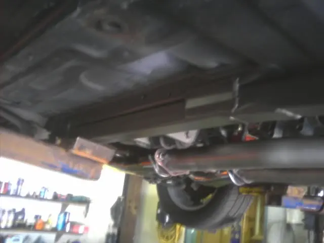

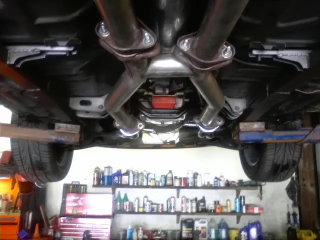

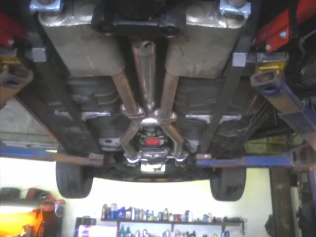

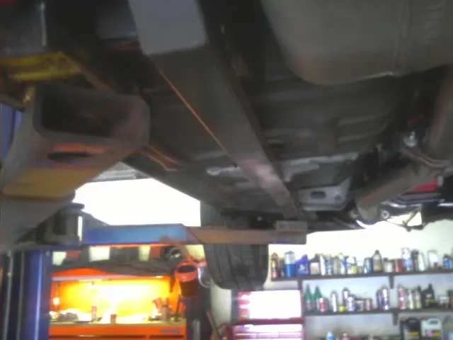

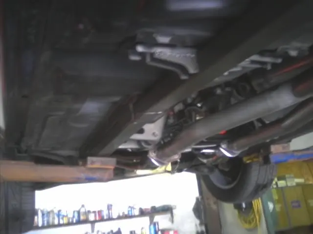

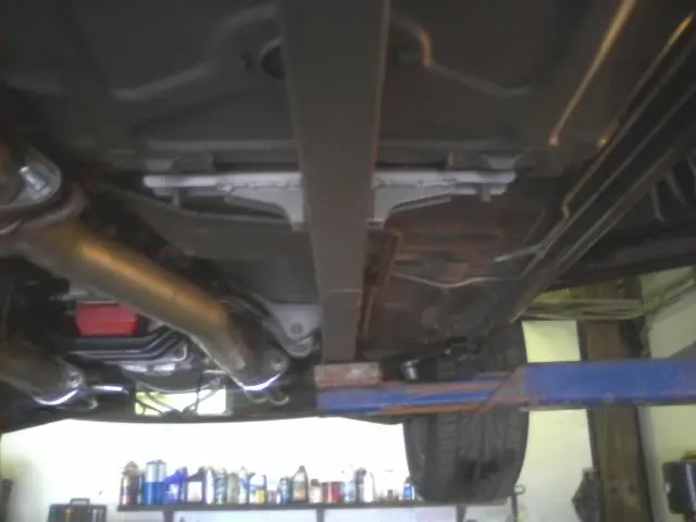

no you cant put a load on the suspension that way BUT i had my mm full lengths installed on a regular lift as well. it can be done. my guy layed on the ground (lifted the car up a little under the axle, etc) and put a few welds on them before he put it on the lift and then lifted the car and completed the job. If your guy has a good reputtation, then im sure he did it this way. As flimsy as the body is without frames, im dure the doors wouldnt close right if he didnt install them right. heres a few pictures of the finished job
