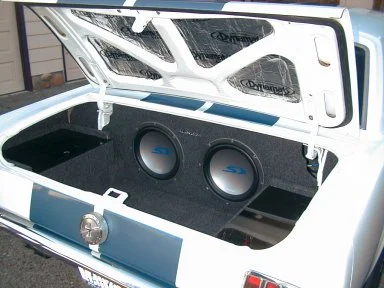

Here's what I did, it hits :D
Had to make custom boxes out of MDF in order to get that nice clean install without too much $$. Only spent around 300 labor for the carpeting and amp connections...so finding someone who knows what they're doing to help you, and a good place to buy will make all the difference in spending a little on an expensive system.
Best of luck.

I dont know how much bass you are looking for, but the 10's would sound real nice, but you would have to build boxes. I dont know if you have a console, but i built one out of MDF and put an 8" dual voice coil sub in it. With 150 watts RMS, it really does sound nice, not car shaking, but you know its there
I don't care for freeair enclosures as you described, using the trunk for the box. You don't get a lot of sound for your woofer. A well braced extremely well sealed box is the easiest way to build a good enclosure with good range. Make sure the woofer you buy is designed to work with a sealed enclosure. Some prefer ported over sealed and some are designed specifically for free air applications. Follow the manufacturers recommendations for air volume.
Another option for building an enclosure for 2 10's especially when space is a consideration, is compound loading. Basically you screw them together facing each other so that one magnet is outside the box. The required air volume is cut in half of what is needed for a single woofer. Now instead of a 2 cubic foot box for 2 10's, you only need 1 half cubic foot for 2 10's. You do lose about 3-5 db with compound loading but it plays much lower bass. If you want to flex windshields with a barely audible note an still keep a spare tire, this is a great option.
