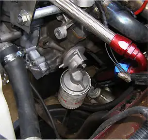

Dont use fram, use a motorcraft FL300, there is also a AC Delco filter I was going to run for my flipped shorty headers on my turbo setup because I liked the blue color, but it still wasn't short enough, I forgot the number i think it was PF13. If those dont work you can always use a 90* adapter, this is what I need to use.
