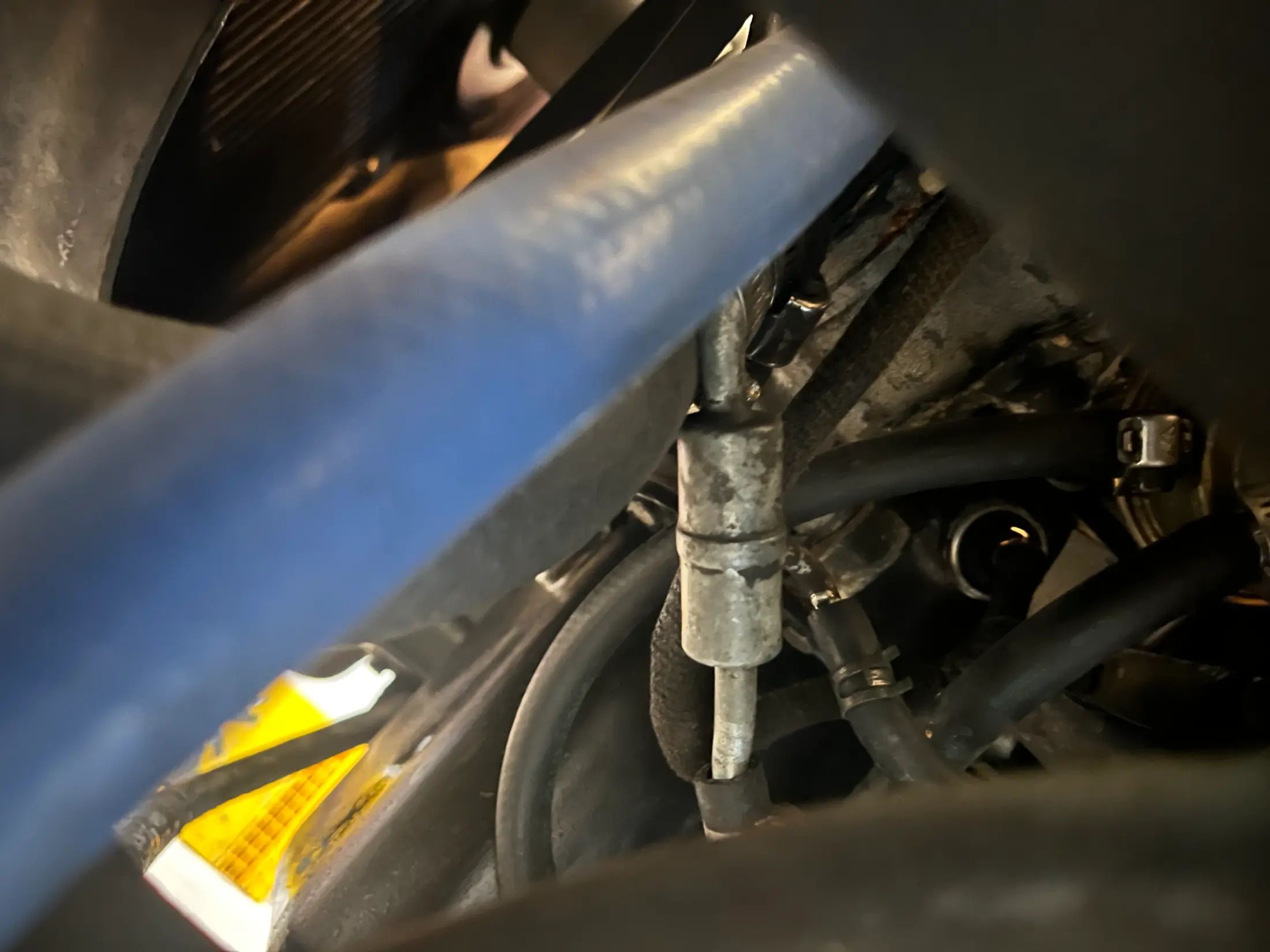

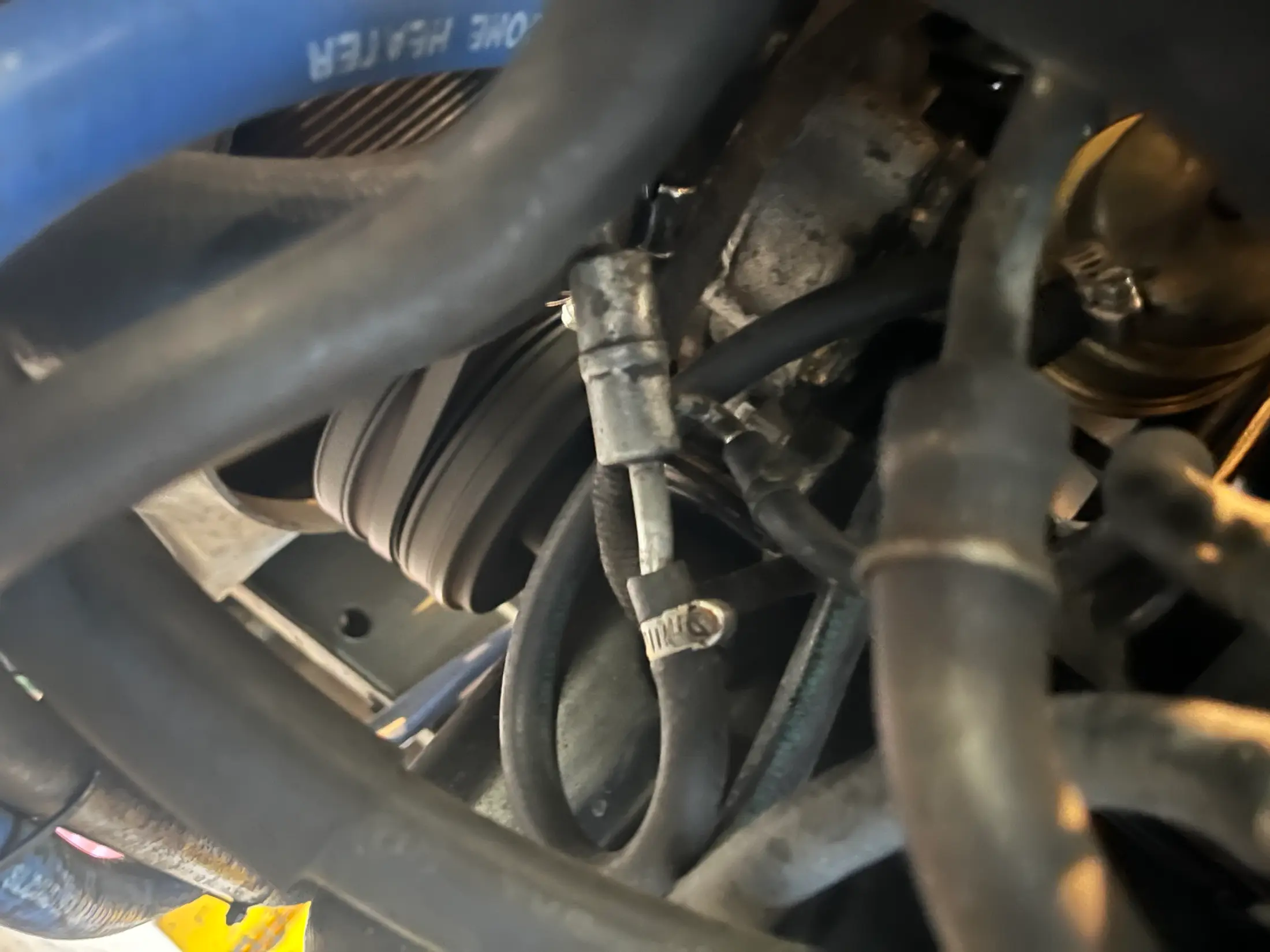

I went to change the fuel filter and don’t see one at all. This has an aftermarket Weber carburetor. I was going to add one to the line and found this odd non-replaceable thing on the fuel line. Like a short cigar. Is this a filter or something else? If it’s a filter could it be clogged and causing the issue? Photo attached.

It does kinda look like a filter..... I'd say that if it's spliced into your fuel lines that it most likely is, or it's some kind of check valve, but a filter seems more likely. A new filter isn't all that expensive, I'd say get yourself a new one and replace it and see where you end up.

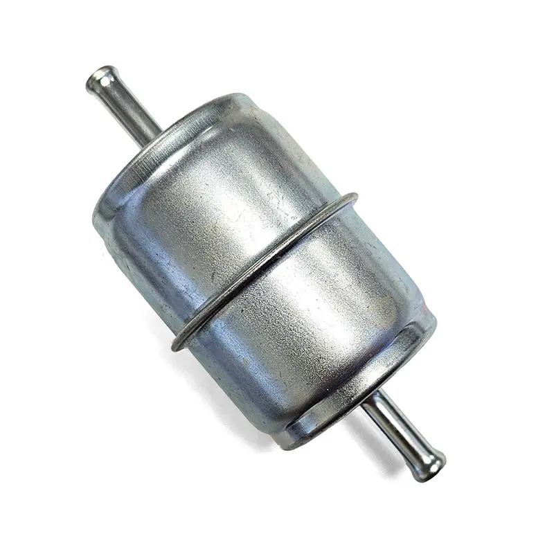

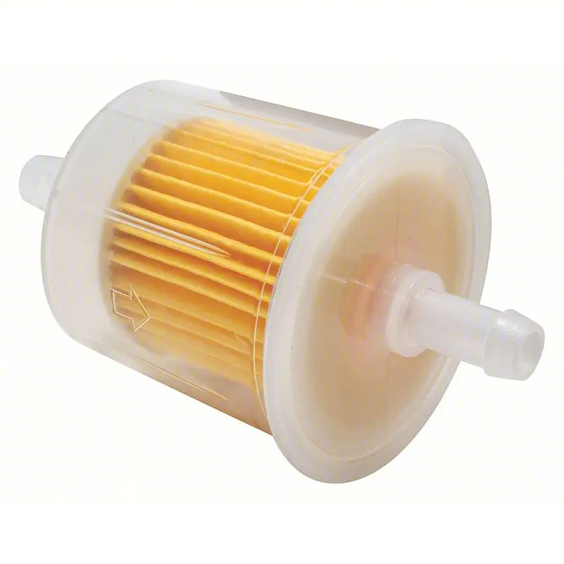

While it's not exacty like what you have, here's another inline filter to illustrate. They're meant to be r/r'ed, not serviced with a new element.
I'd suggest picking one up like this one so you can at least see what you may be working with.
I'd avoid the filters that you can take apart only because it's another potential point of leakage.

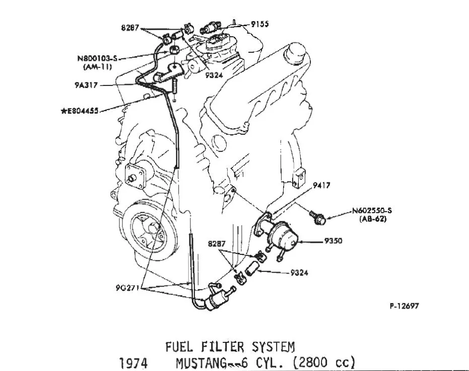

The part in your photo is not a fuel filter, it is part of the fuel vapor return (9G271). The fuel filter originally would have been threaded into the carb, item 9155 in the photo below. It may have been left off when the Weber carb was installed or replaced with one like shown in above posts.

Thank you - that's it! I appreciate the help, it's defintely the fuel vapor return. I'm guessing this is a smog prevention design, but not to prevent vapor lock or it would be closer to the carb.
