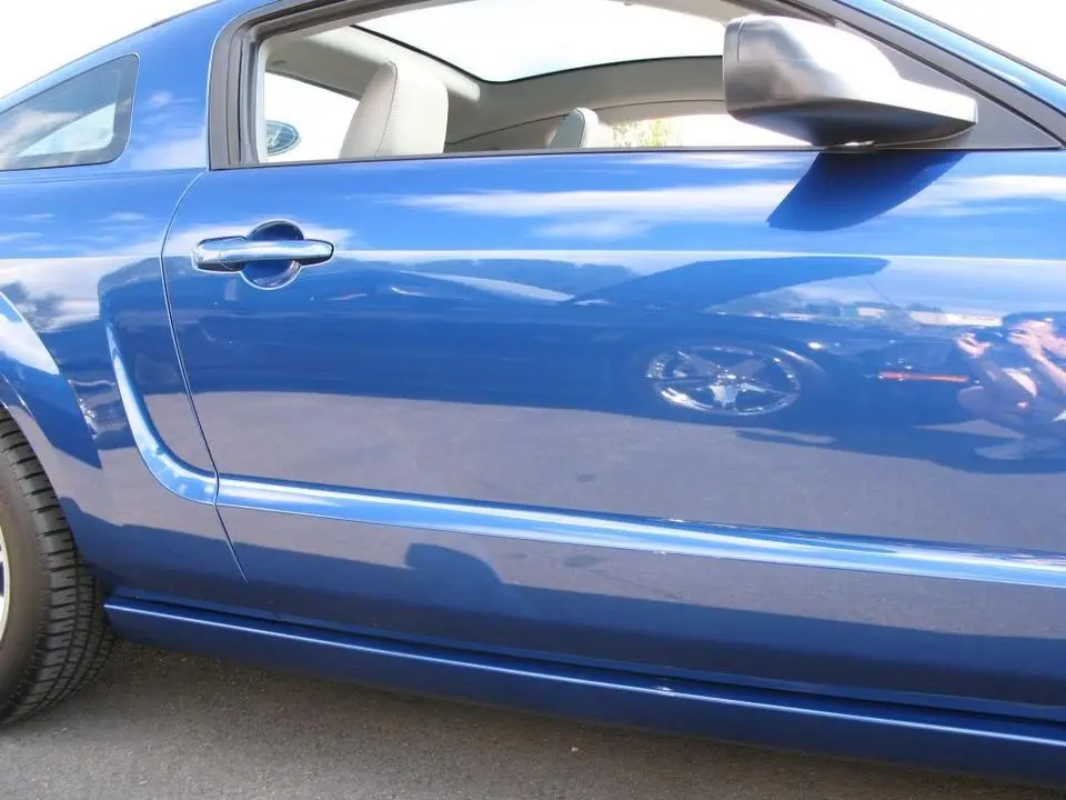

I have a glassback, here's a shot from inside kinda:
