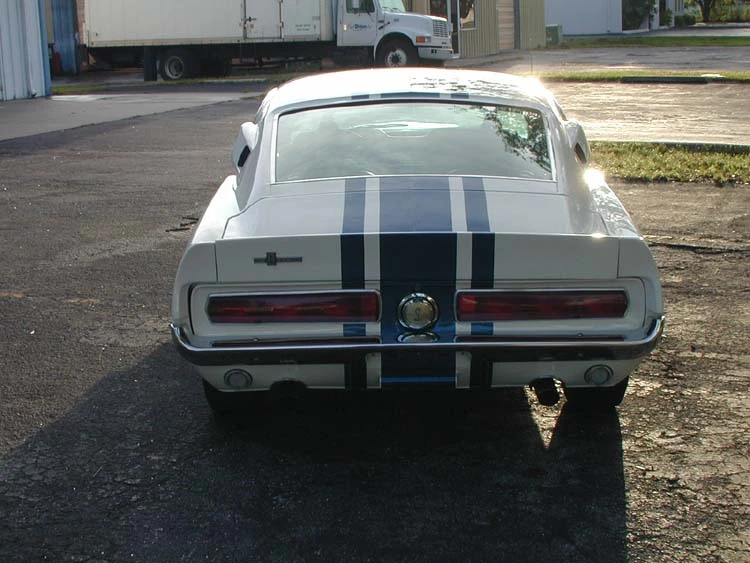

Any one know the stripe dimensions on the 67 Shelby Super Snake? All I know is that it was a narrow-wide-narrow striping all down the car, and was similar to the LeMans striping on the side, but I cant find to see the actually dimensions anyway. Anyone know for sure?

They are this big.
haha nahh sorry i dont know.

Yeah, unfortunatley all I have is pics as well, and I dont know the area between the lights on the 67" to try and base the others off of. Anyone have any ideas? or does any one have the side gt350 stripes they can measure for me so I can scale that up?

I will ask a person that owns to make some measurements and post his response here.

measurements taken straight off of the car
Spacing and width are the same from front to back. Total width is 20". Center stripe is 10", outside stripes are 3" with 2" between stripes.
