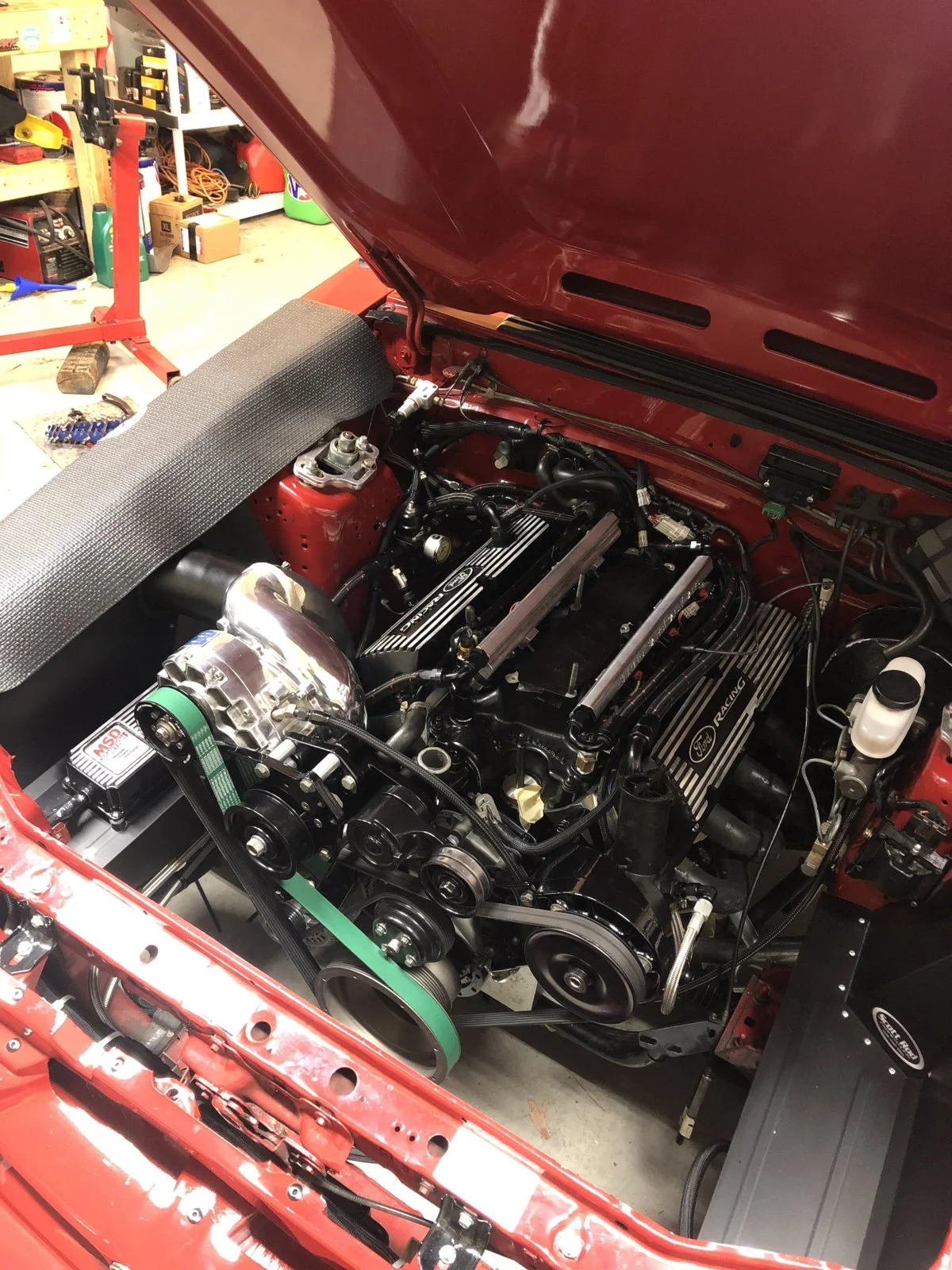

Two 10 fittings off my valve covers to a Moroso can hidden in my fender . You can see them in th pic and then they into the strut tower
