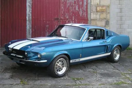

I personally like the Acapulco blue (or something deeper) with white stripes.
