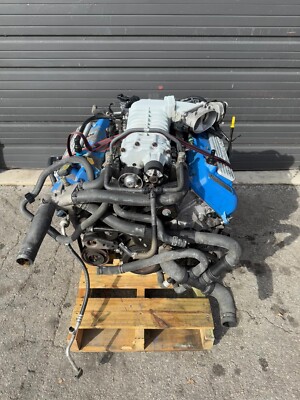

Third option i am thinking about: Is buying a complete gt500 engine which is for sale on ebay with 100k milage for 8k. Problem that i see here is mainly is the condition of the engine itself cause i cannot check it as its in the us and also i see a problem wirh the position of the alternator and that i might have to change steering shaft etc... and of course getting it runnig with the 4r100 trans.... I think it would work with original Shelby ecu and a compushift trans computer... any opinions on that ? i can post the link to ebay below...

If you're going to [order] and engine anyway, why not get one that [fits] the car without a lot of drama?
Your plan to use the original ECU also means that you plan to use the original ECU harness... [That part] is a pain in the ass, not to mention whatever bell housing, k-member, engine mount, etc..., issues you may run into.

There is no Supercharged engine available that fits directly... and its a used engine... which is in my opinion cheaper as if i built a 2v or 4v to achieve the 500 hp...kenne bell super charger kit is around 5k and forged connector rods and new machining on the engine will cost as well....

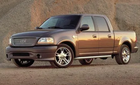

Harley trucks came factory supercharged
