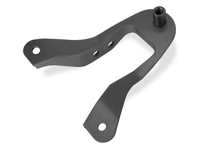

This is the upper control arm mount. I've never messed with anything adjustable. Which hole would I use?

Whichever one matches your stock mount. Apparently they made that mount to fit both '05-09's and '10-14 cars ('10-14 had a longer upper control arm)
