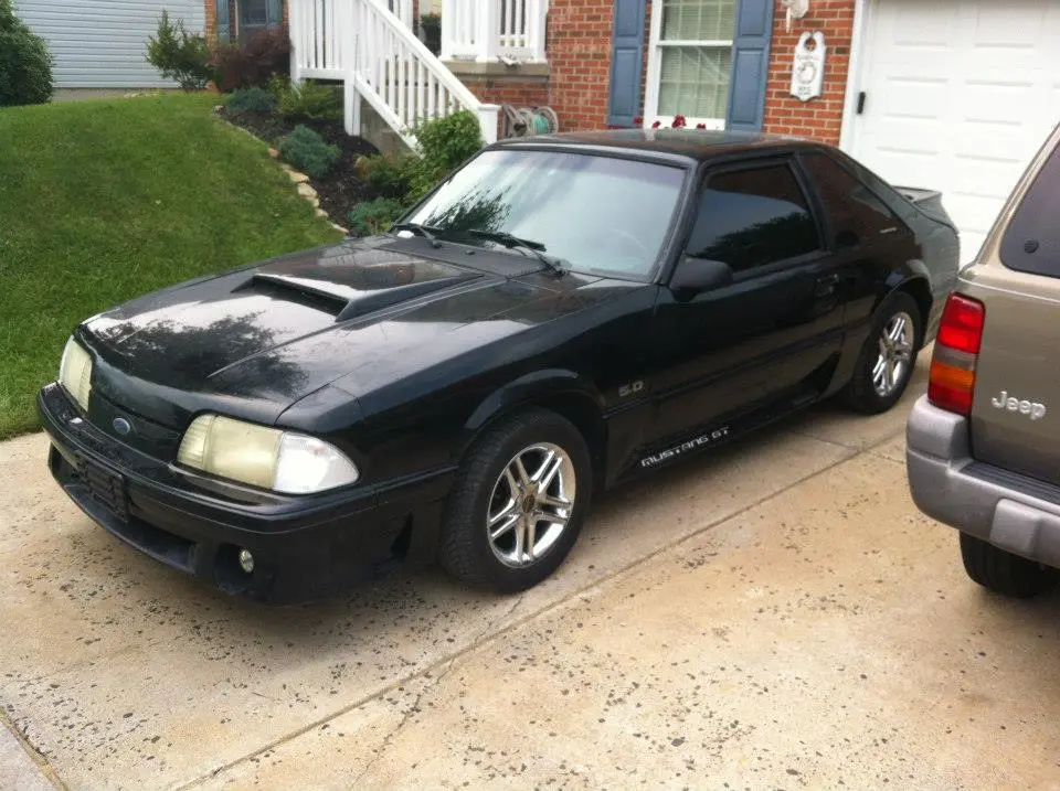

Here's a visual, I know, some nice skinny small tires on there.. but for 3000 with no rust i wasn't gonna say no
It "adds" hp:shrug:..... dunno I've owned 11 second convertible mustangs that still had all the a/c. p/s and rear seat.
For suspension, low budget is 4cyl springs up front and a bag in the right rear spring, 90/10 and 50/50 shocks, and replace the rear uca bushings. A step up and proven setup are tokico 5 ways, eibach drag springs, and a good set of adjustable rear upper and lower control arms. If you have the money go coil overs and weight jacker lca's. I'm sure others will give their recommendations as well. These worked for me over the years.
