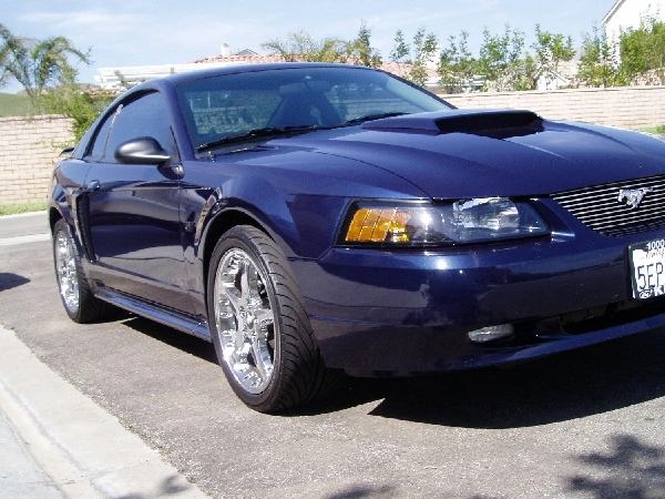

My 03 is a DD and I do a daily 65 mile RT. I chose the Eibach Pro-Kit for that very reason. I wanted stock like ride quality and added handling. I got exactly what I wanted with the Pro-Kit. Mine dropped just under 1-1/2 in front and about 1-1/4 in the back. With a good set of standard tools, jack and some jack stands, you can do the springs yourself.
