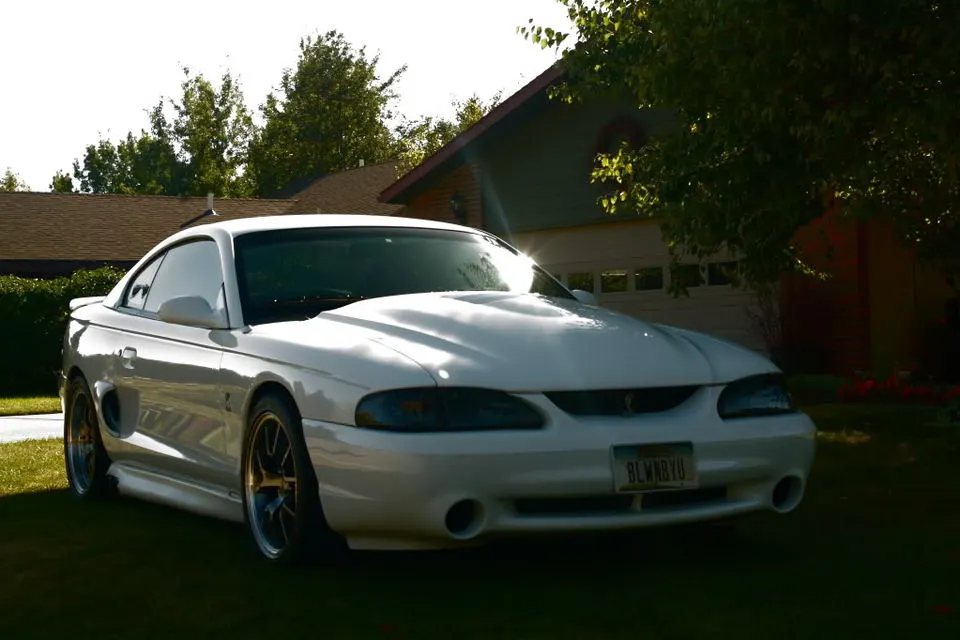

Probably just the logistics of them. I hardly ever see a Mustang with them. You have to have a special exhaust just to make them look right, and it ends up being a lot of money. I would love to have them now, so that I didn't have to put tail pipes on my car once a year for emissions. But I'm not willing to buy a whole new cat back for it.
Kurt
Thought abc's looked the exact same minus the "svo" being in them?
Are they shaped differently and im just blind? With more attachment points plus them bring urethane....i dont see how ABC's are not superior. :shrug:
that's right, Nate: ABC's look exactly the same minus the SVO on them. shaped the same too w/the exception of a lip that runs along the inner door sill so you can mount them there, too, aside from just the spots at the wheel wells.
Under further review, are the SVO skirts a little different under the side mirror? It seems like they curve a little more or something. May just be the paint reflecting different...

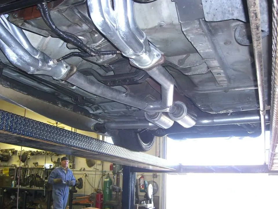

Courtesy of TurboGT:
You have room straight off the headers (thats if you are running long tubes) it looks like the dynomax bullet mufflers should clear the humps in the crossemmber. You could create even more room if you cut off the collector of the long tubes and added the muffler right away.
