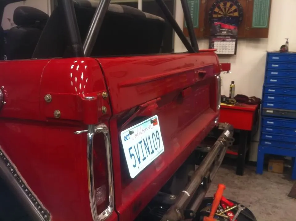

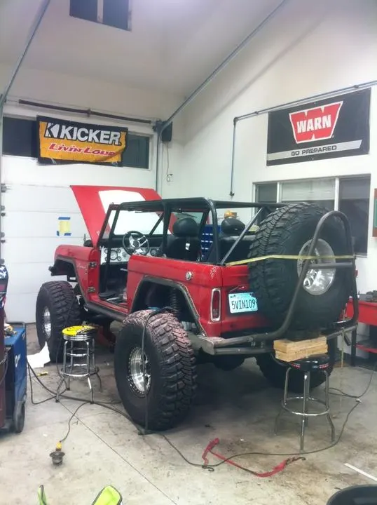

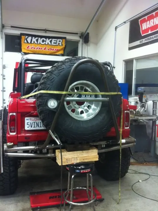

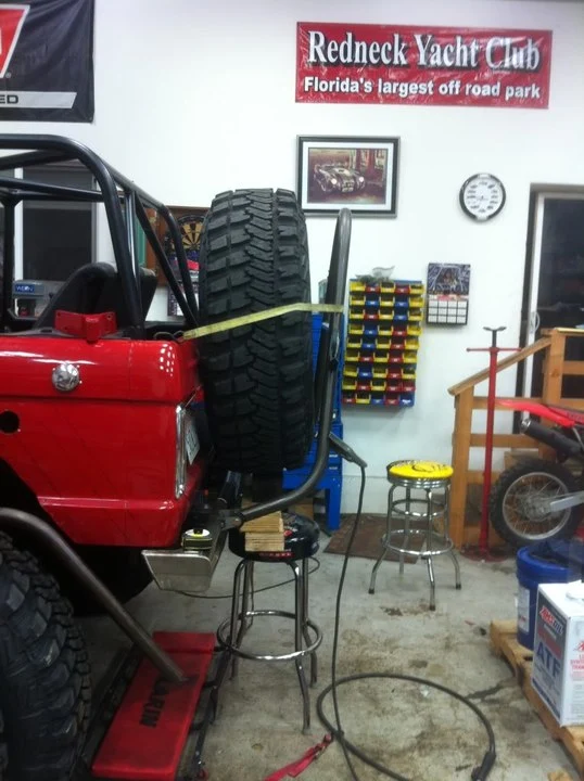

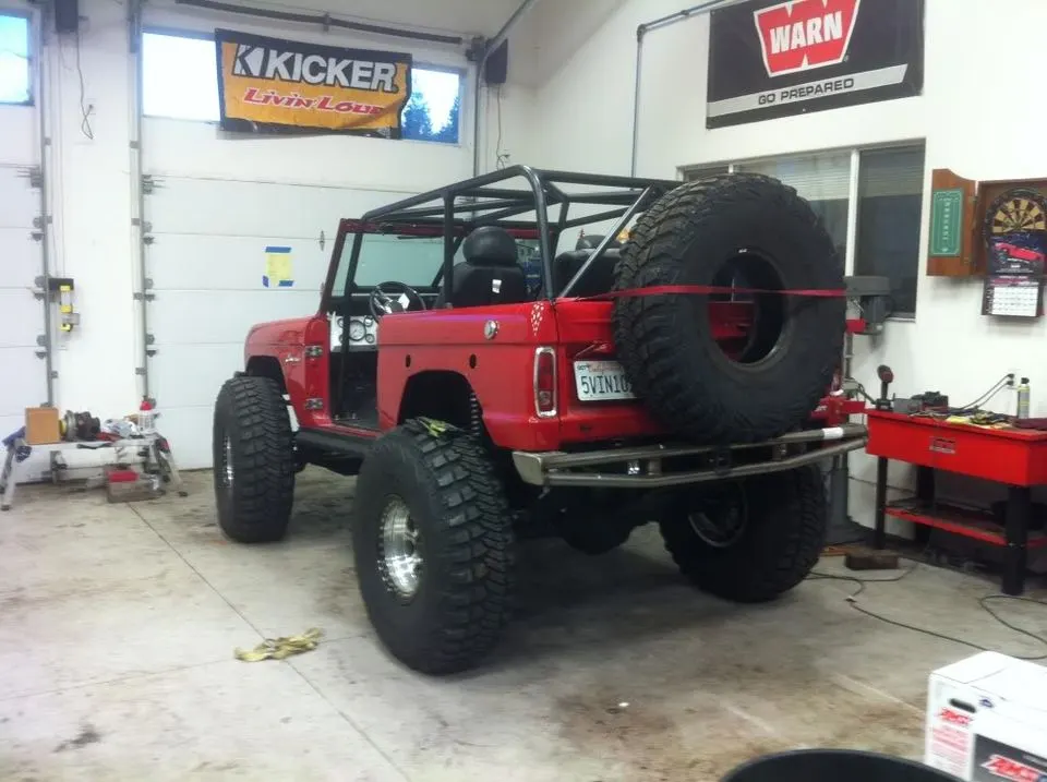

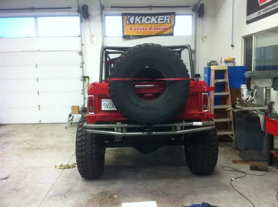

Well money's getting tight so I improvised on the spare tire carrier. lol J/K

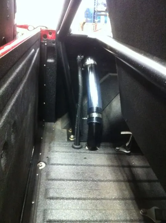

Just propped it up to try and get some measurements on angles and spacings. Also realized I never posted up a pic of the gas filler neck and return in the new location.

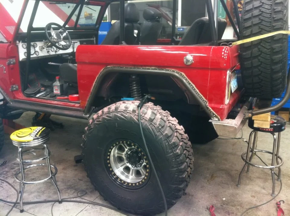

UPDATE 3/30/11

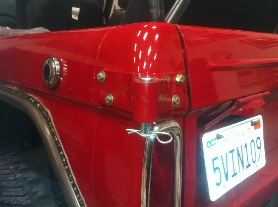

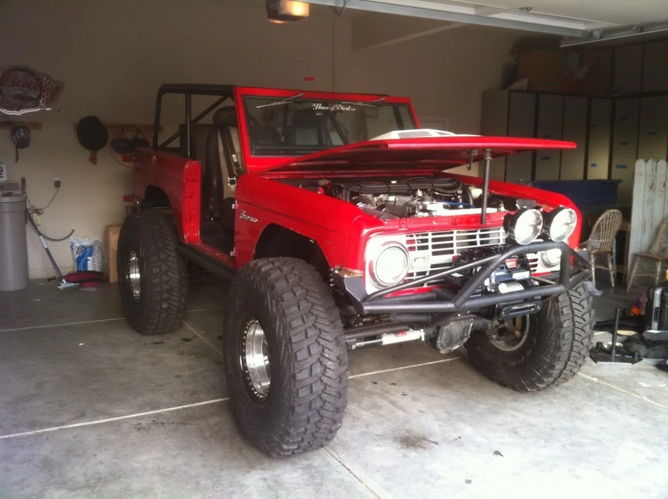

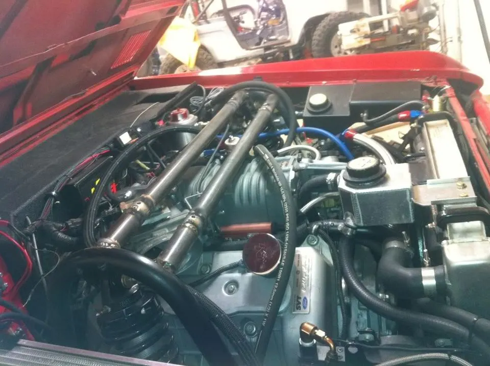

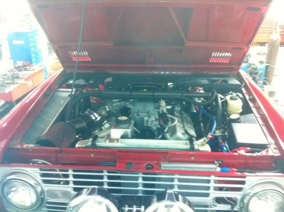

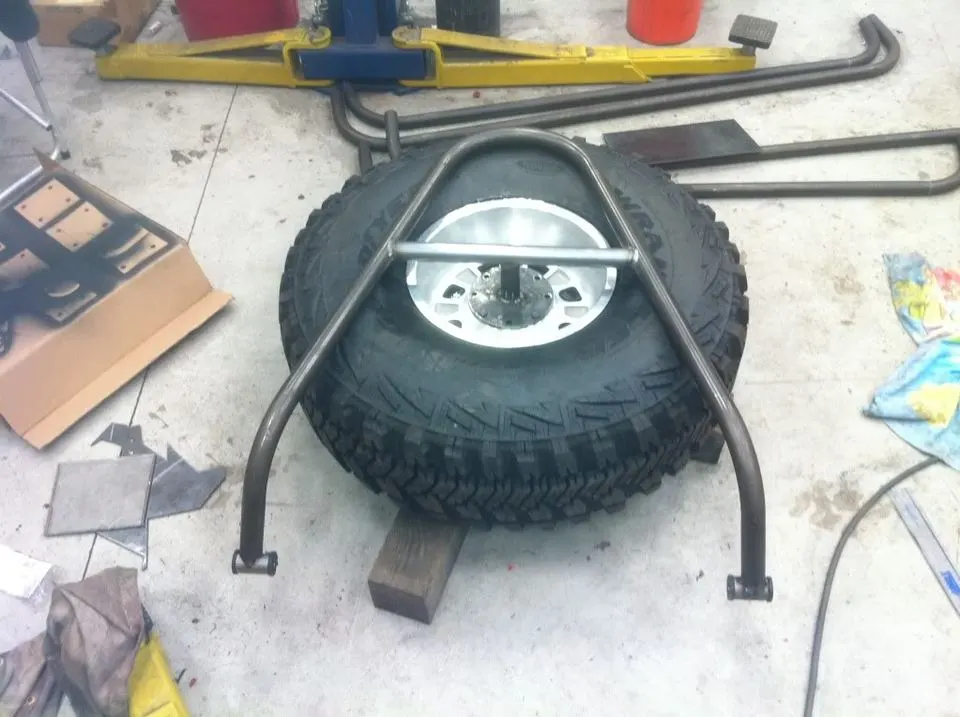

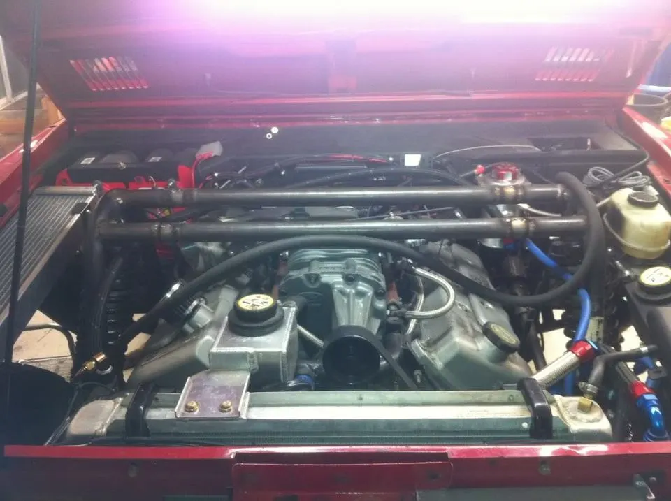

So I got everything bent last night that I need to finish her up, plus some. Even got the tube for the Miata Baby Bronco bent up. Probably take me through the weekend to get everything up and in since I bent like 3 sticks of tube last night. Spare tire carrier is tacked. But is cutting the tire plate today. Looks like my idea of taking the bottom OE hinge and flipping it up to the driver side is going to work perfect. Plan on using safety lock pins to lock it in. Something easy to pull off that won't grow legs, require a tool to unlock, and no complicated latching assembly that just wears out. Will probably use a little patch of Teflon or rubber between the plate and OE hinges to minimize rattling. Finally clicked an under hood shot too. Only major thing left to so under there is complete the hoop brace.

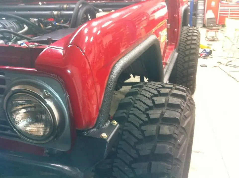

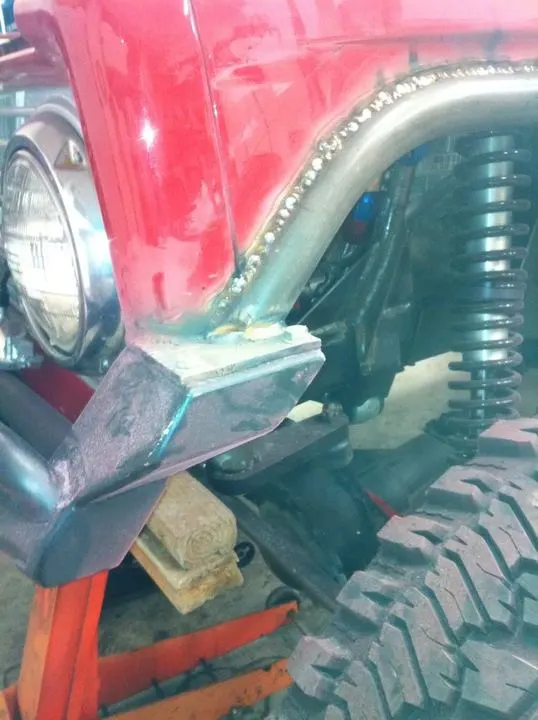

UPDATE 3/31/11

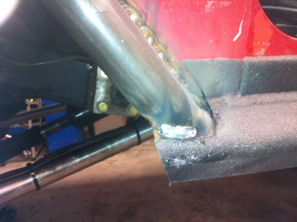

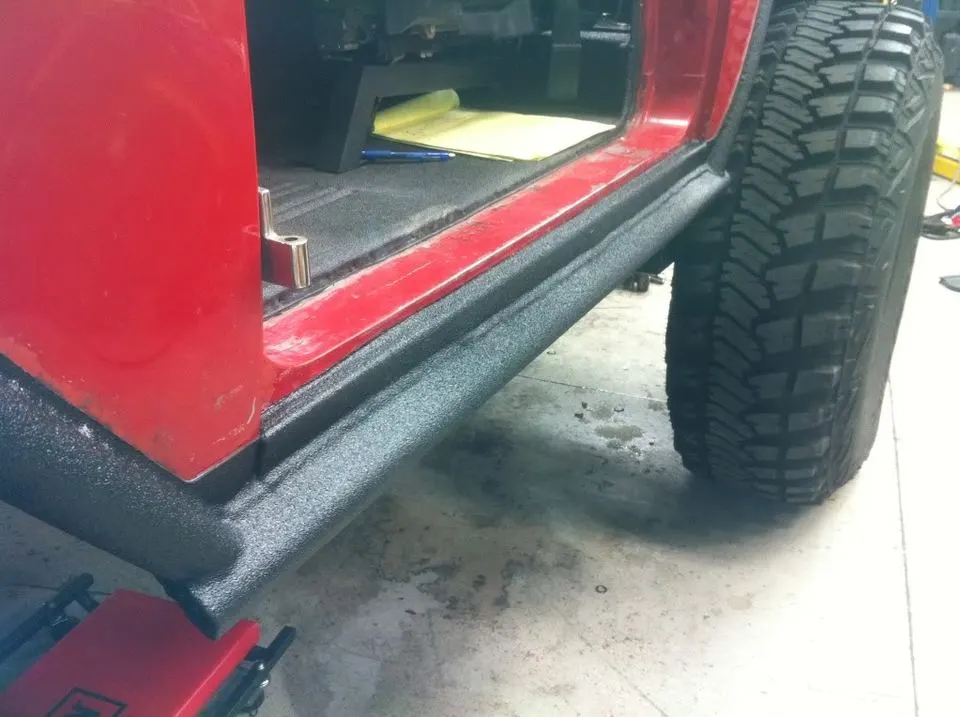

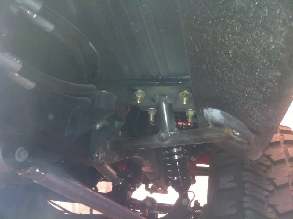

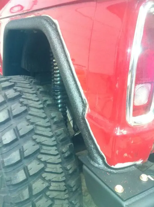

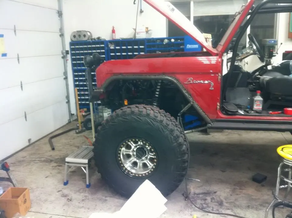

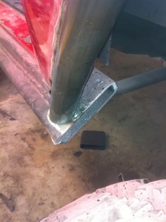

So welded in the driver side tubes last night. I hate welding body work. It takes foooooooooooooorever. Oh well front was a pain but the rear went fairly smooth. I think I'm going to get the tubes LineXed. But I'm really happy with the lines and only had to put a couple small 2-3 degree bends in to make it somewhat follow the contour of the body coming down into the sliders.

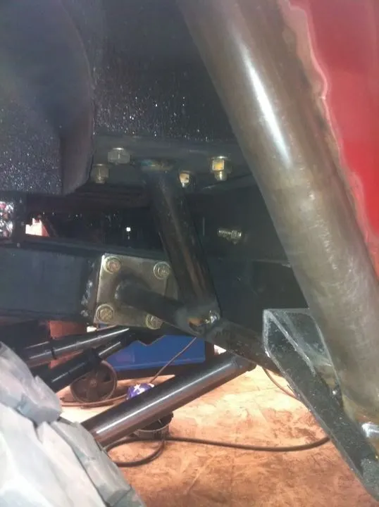

UPDATE 4/3/11

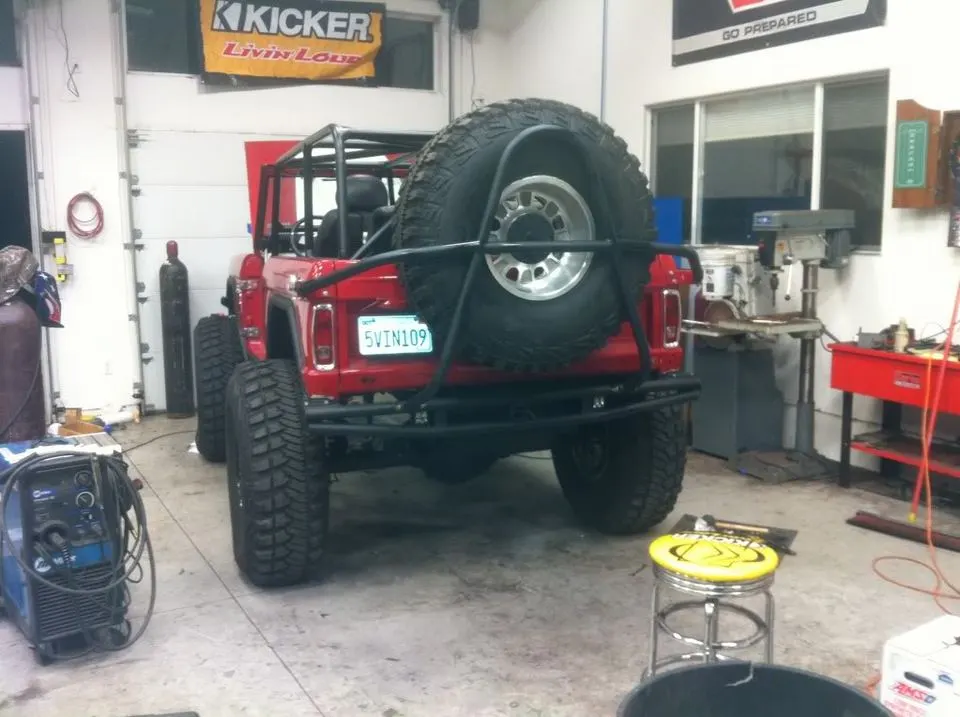

So got the mounting plate for the spare tire all welded in, flipped and bolted up the driver side tire carrier attachment, and welded in the rollcage supports. She's off to LineX on Wednesday for spray on the fender tubes. All that's left before LineX is capping the 2x6 sliders, front tower brace, and possibly rear spare tire bars if there's time.
Front Support
Middle Support
Rear Hinge Flipped and Bolted to Driver Side

Well Friday night was crazy but got most things done I wanted to on the list for the show. Tower support still gets a cut plate tying them together with House of Diesel cut into it. Tire carrier came out great just took forever with the grind fit, grind fit, grind fit on the corners. Got finished up about 1:00 AM Saturday and went to load the trailer and the new Superduty has a Class 5 Hitch so I had to wait till the morning to leave. Put us in SoCal early afternoon to get the rigs washed and cleaned up. Dang SoCal Saturday traffic is retarded. Well here are a few pics of last minute updates. Will post Monday or Tuesday all the picks from the show.
