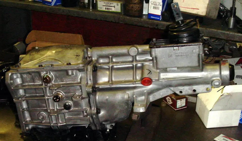

I noticed a small amount of fluid in the driveway and after I jacked up the drivers side , I noticed a small amount of fluid around the torx bit on the drivers side of the tranny( that holdes in the slider I ... think) I am pretty sure it's a no no to back this out but what about trying to tighten it? Just want to make sure I can't hurt anything as I can not afford a rebuild !! to stop the leak is there a sealer I can put around or should I just try to tighten it up a turn or two?

which one the top one or the bottom one?

bottom one

dont loosen it! its the drain! give it a little turn to tighten it! not to much just a bit!
No its not. Those are on the other side.
The bottom one is a retainer for a spring used on 91-later t-5's with a torsion type spring on the 5-R reverse lever.
This is, the OP has an '89 so if it's the original trans he shouldn't have it.
The top one holds the 5-r lever in place. Do not remove this, but you can tighten it fine.
The one with the prongs is the reverse switch. You can remove this one fine

opps my bad !! i should have looked at the pic! i thought he was talking about the other side!
