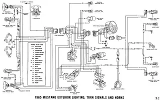

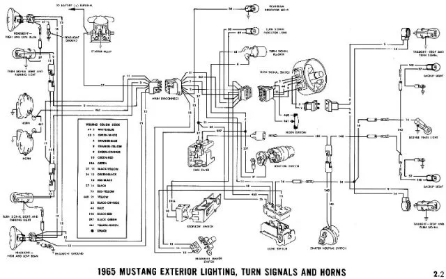

Dash lights can be a pain. The small fuse in the center sends power to the head light switch where it runs through the rheostat (dimmer). If the coil gets corroded, you will lose the dash lights. You can try to clean the wiper, but be careful you don't knock the carbon brush off the copper wiper. I have also seen (read ran around in circles for hours) where the wiper corroded between the wiper and the carbon. Dang! I had 12v at the wiper, but nothing on the coil. It finally broke off. New switch fixed that. You can take the headlight switch apart to clean the coil, wiper and glue the coil back into the ceramic if it's loose. Just remember how it came apart...I'll try yo attach an image of the wiring. ALso, the fuses and holders can be rusty. Make sure thats. not a problem. And lastly, I have run this problem into the ground at least three times. The wire, where it's crimped to the fuse holder clip on the backside of the fuse box, can become corroded and intermittantly make contact, or not at all. Take the 12v probe and press the point into the crimp to see if THAT'S the problem. Wiggle it around to get the wire to make contact with the fuse clip. THis is if you don't have power to one side of the fuse and you know you should. Meaning there is 12v on the wire but not the fuse clip...

thanks for the wiring. I took the connector apart from the light switch & I have power coming in on the Blk/Orange but no power to the brake wire or the taillight wire. I did wire power to the brake switch on the green wire & the brake lights came on. Somehow power is not getting to the brake light wire on the light switch module. I pushed the pins in & no difference.
