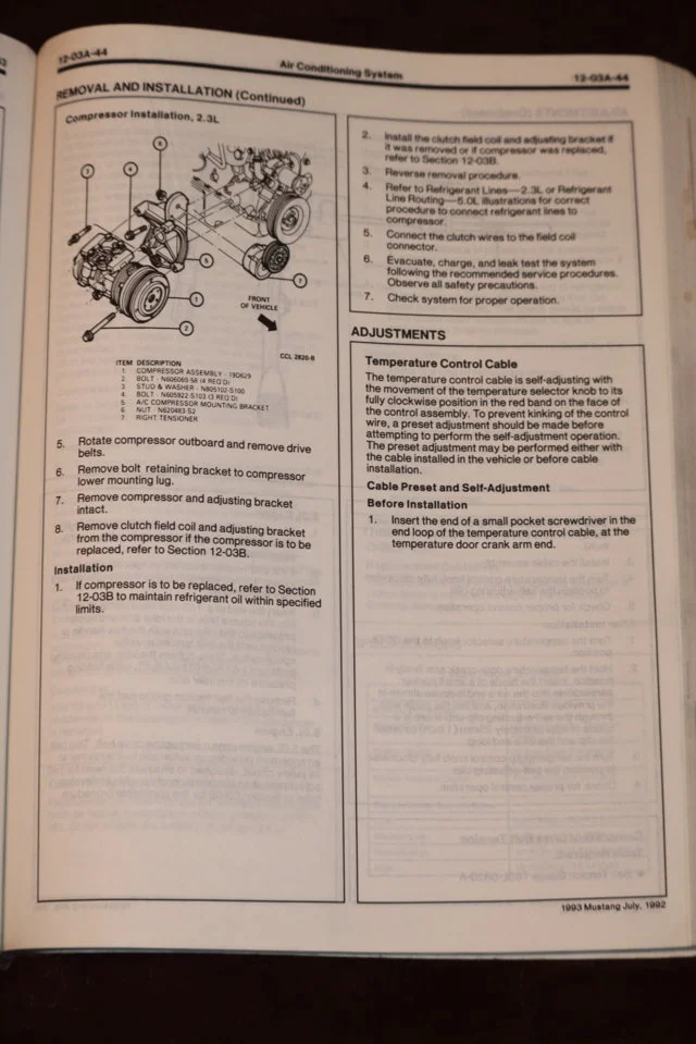

Not sure if its your issue, but from the book. I've never had to do it, but maybe some one here can explain the procedure better.
Start from Adjustments.

I am using a brand new cable and I have this book.
The cable moves freely and the knob turns smooth until I hook it onto the arm at the blend door.
Like I mentioned I can easily move the arm at the blend door with my finger and I hear it opening and closing.
What is the purpose of the spring on the arm door?
I removed the spring thinking it was bad or too strong but same issue persists.
At times I can get it to turn smoothly to warm but same issue when I turn it to cold--it doesnt go all the way down and springs back a little bit. Like there is no positive stop on the cold side, feels like I can keep turning it till it breaks.
The gear tracks behind the knob are clean and clear of dust or debris.
