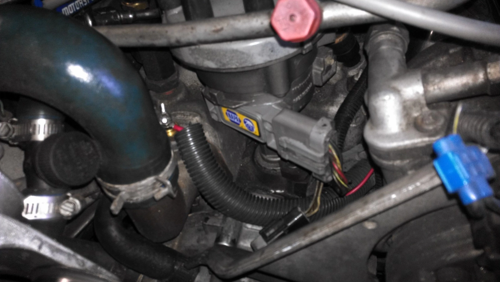

So it looks like my TFI module is doing the common car gets hot etc in traffic and wants to die. It's done it 3 times in 3 months, with all the same characteristics, always cranks when cool, no idke issues or stalling while driving, runs perfect, never dies cool, dies only after warmed up real good, never when driving only when I come to a stop when really warm, like after 40 min of driving etc in traffic, real hot etc.
**walbro 255lph fp less than 2 years old, fpr less than 2 years old, fuel pump relay less than 3 months old, injectors were cleaned less than 2 years ago.
I know most TFI modules are cheaply made, so here's my question if there is a known problem with the production motocraft ones, did they address this in the ones produced now?? I have some artic ice heat sink that I will be adding to the new unit but from the brands I'm looking at, here are the links to the pricing and products, looking at the motorcraft one, Delphi-(also original OEM equipment with the serial number etched off I believe) or the Echlin,
any advice on this purchase guys?? :shrug:

5 year warranty is a little piece of mind.....fix your problem at least?
Exactly!!! .....piece of mind is good for sure :nice: it's really 5yrs or 50,000 miles so I'll say Hellz yeah on that. Got it installed with a great heat sink job and fired her up and she's purrrrring great, haven't done the extended heat, sitting in stop and go yet but probably tomorrow. Here she is...
Don't even tell me what the scotch lock is in the pic. Just get rid of it. Burn it with fire. They have absolutely no use on this Earth.

That scotch lock is the negative side of the clutch relay to complete the circuit for the electric fan auto turn on when a/c is on. Had that same one on since 2001, never had an issue, ever :shrug:

Also I was able to preform 'after engine was completely hot' - 4 separate reving idles for 25min each time during 70* and 80* temps and the TFI module today never cut off the car :banana: Was testing a coolant product water wetter, took before and after pics of the temp gauge in another thread, it went real well, good day under the hood for sure :flag:
