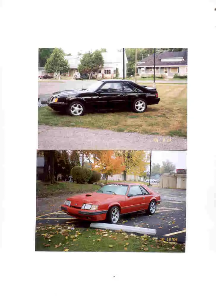

The 94 to 97 cobra wheels will fit ok .I done the sn95 cobra swap so there are a lot more wheel combos for my svo
