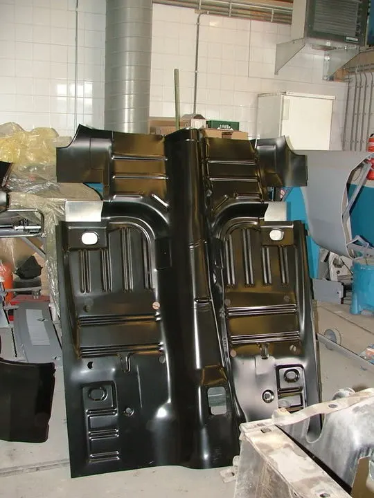

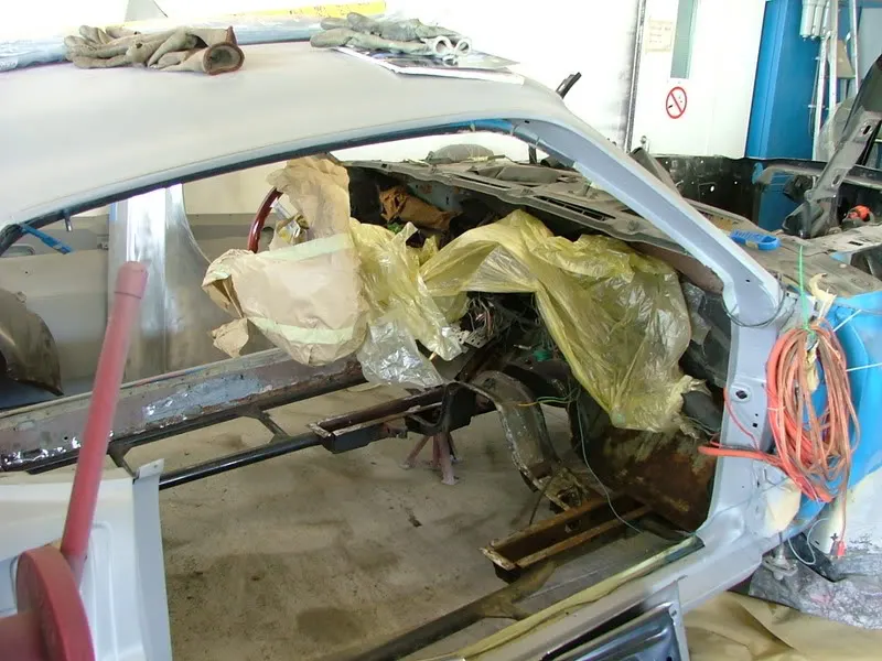

Old rusted out floor pan
has been cut out out. Those Global West subframes you see are the only thing that kept me from having to crush the car following the accident.
after the new one piece floor pan is fitted, it will be epoxy primed and painted with the toughest marine paint known to man and installed.

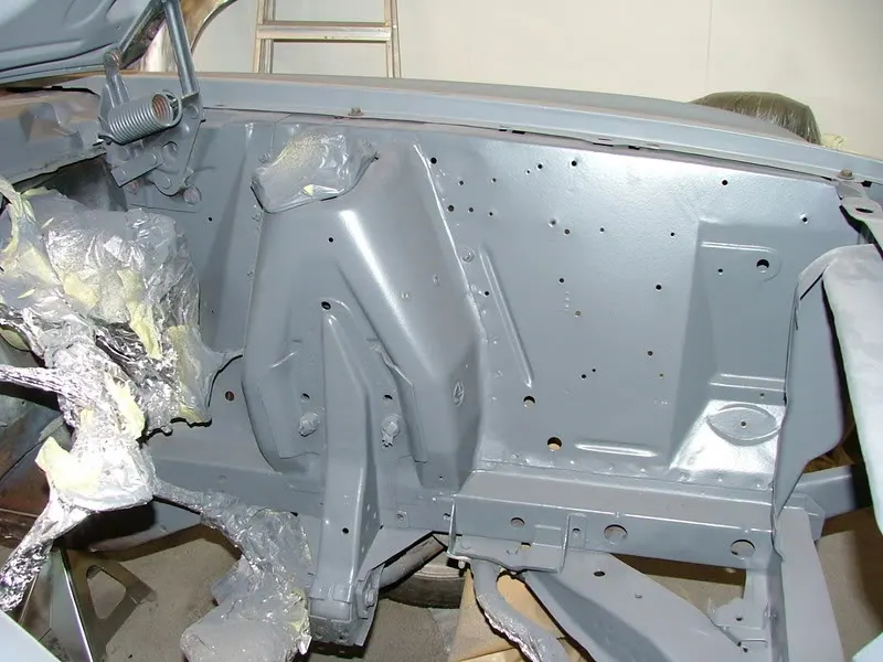

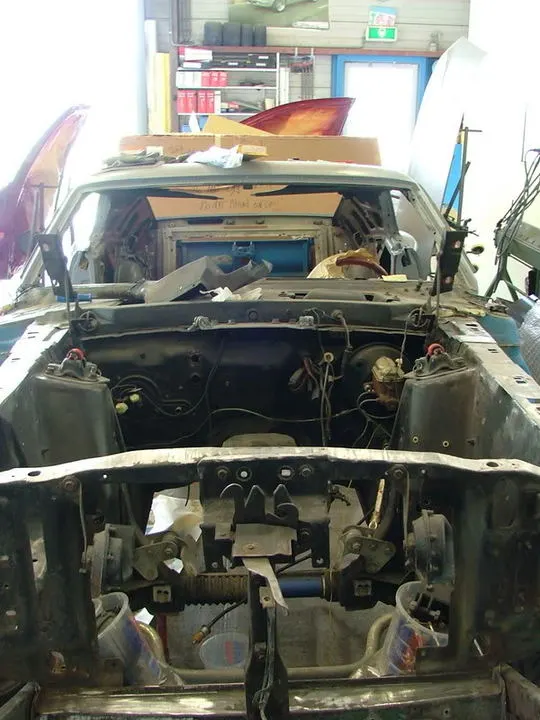

This is the engine bay last month
Here it is today. It is primed now but will be painted flat black

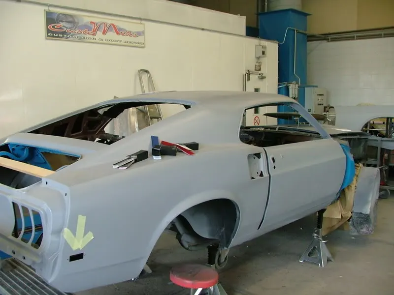

The passenger side door is finally fitted and primed. It was a ton of work.
The shop tells me the NPD torque boxes were absolute crap and that they had a hellovatime to get them to fit.
