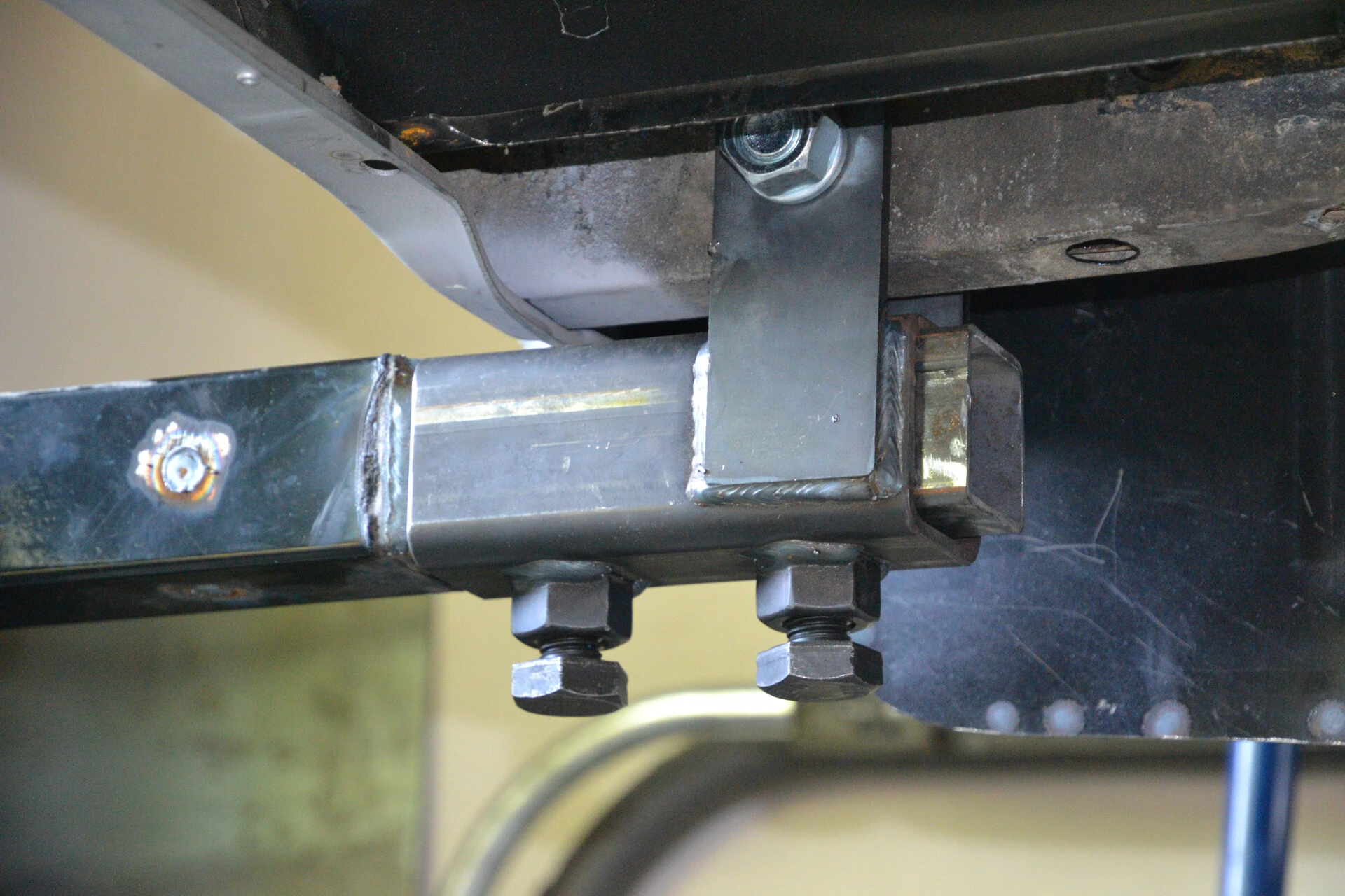

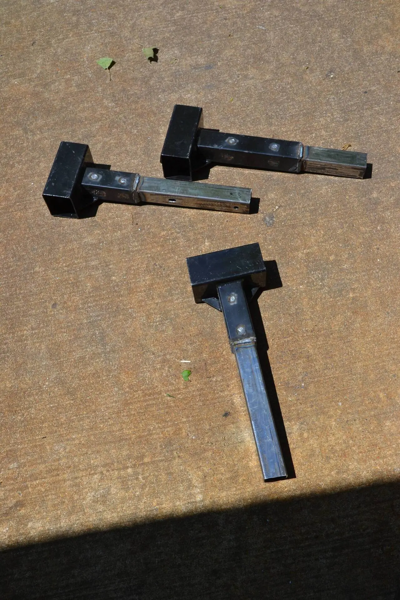

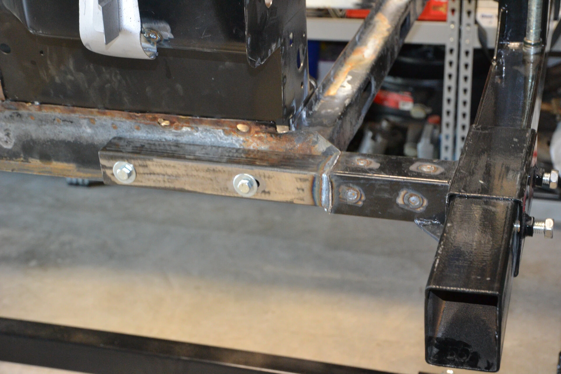

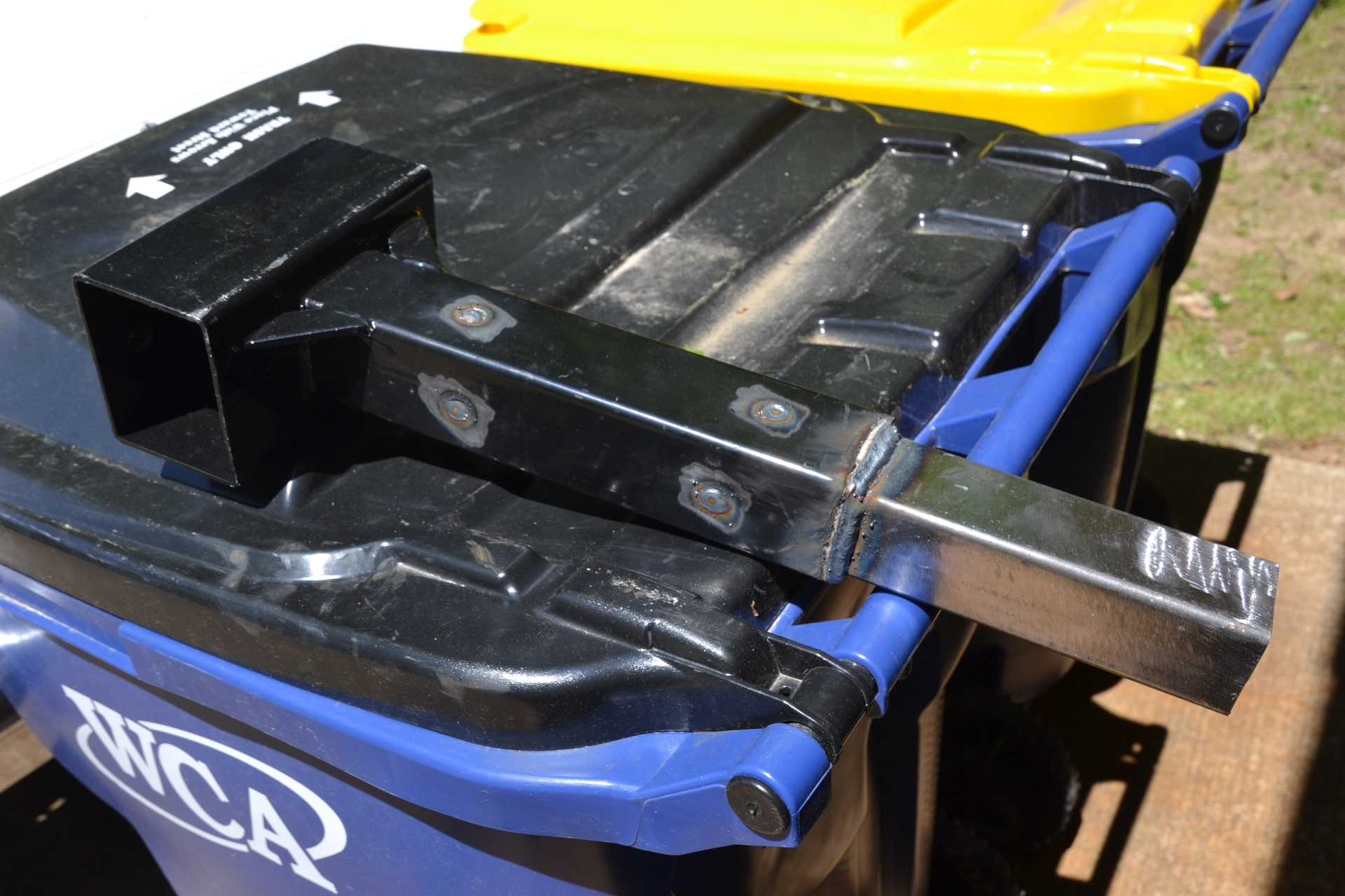

The car should be in the air tomorrow. I still have to weld up my modified mounting brackets.

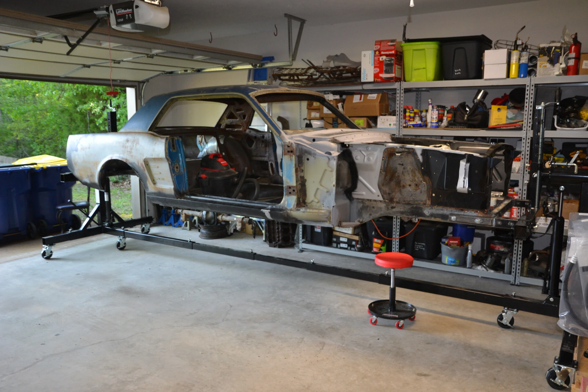

It was worth it. Got everything mounted up and it's in the air. It's too tall to spin it inside the garage without bumping it into the bottom rail. I'll have to move it outside if I want to spin it. No big deal.
The modifications of the mounting brackets turned out really well.

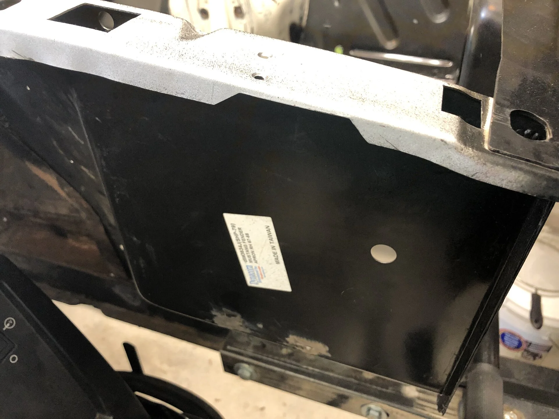

You can see in the last picture in the post above my sorta solution for the passenger fender headlight bucket mount with the ‘67 battery tray. This just consisted of the section of the ‘66 battery tray that I cut out to keep the mounting bracket.
I was never really happy with this, so I decided to tinker with the car a little bit. I drilled out the spot welds for the bracket and removed what was left of the ‘66 battery tray. The new plan will be to add more metal to the bracket, thereby extending it to meet the outside of the ‘67 battery tray.
