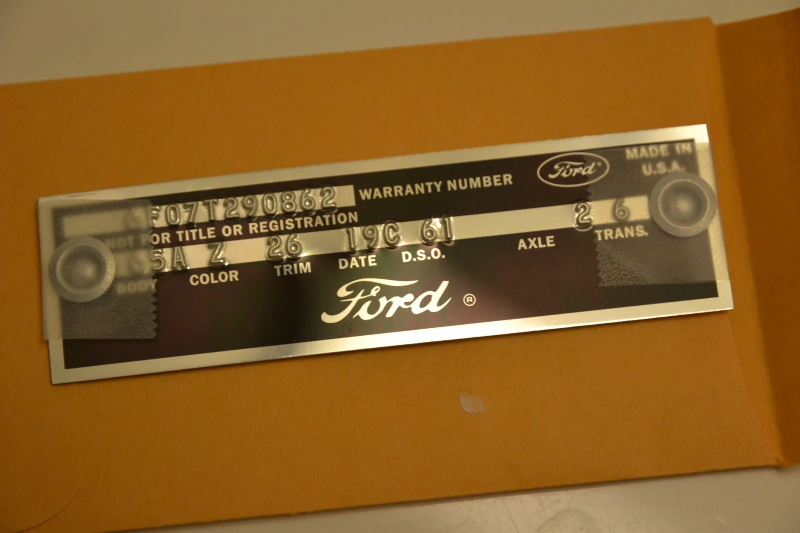

It'll be a long time before this gets installed, but I figured I'd go ahead and get it now. The old tag was covered in that horrid blue paint.

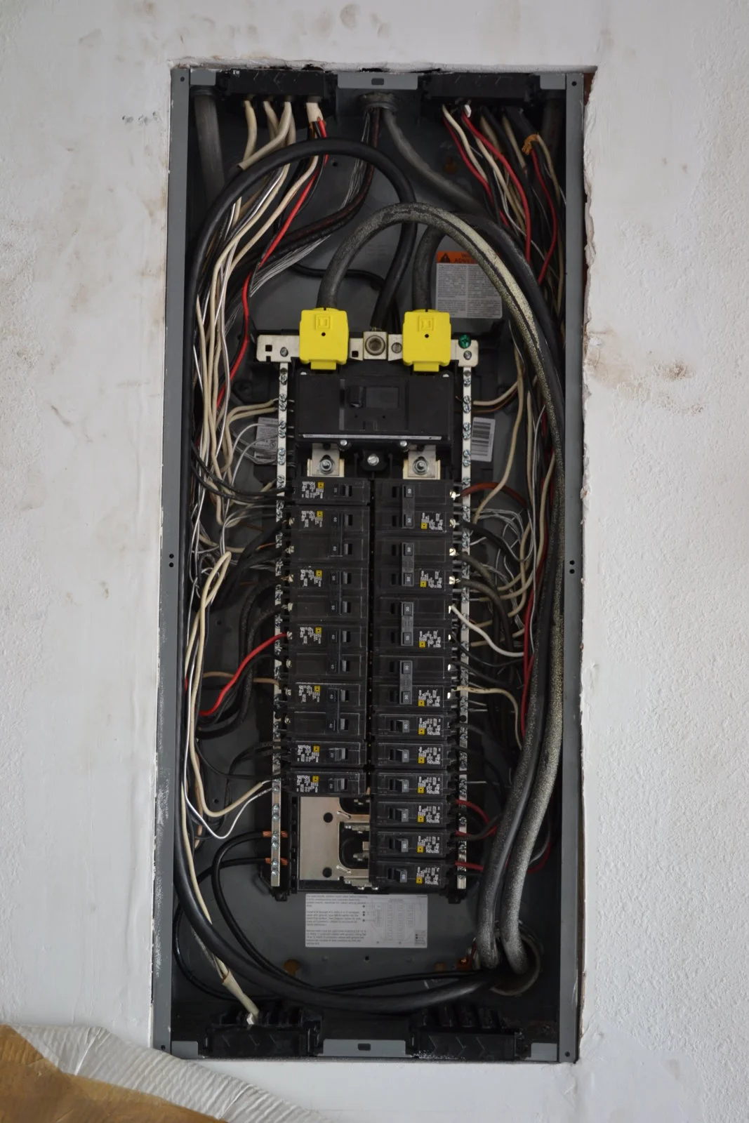

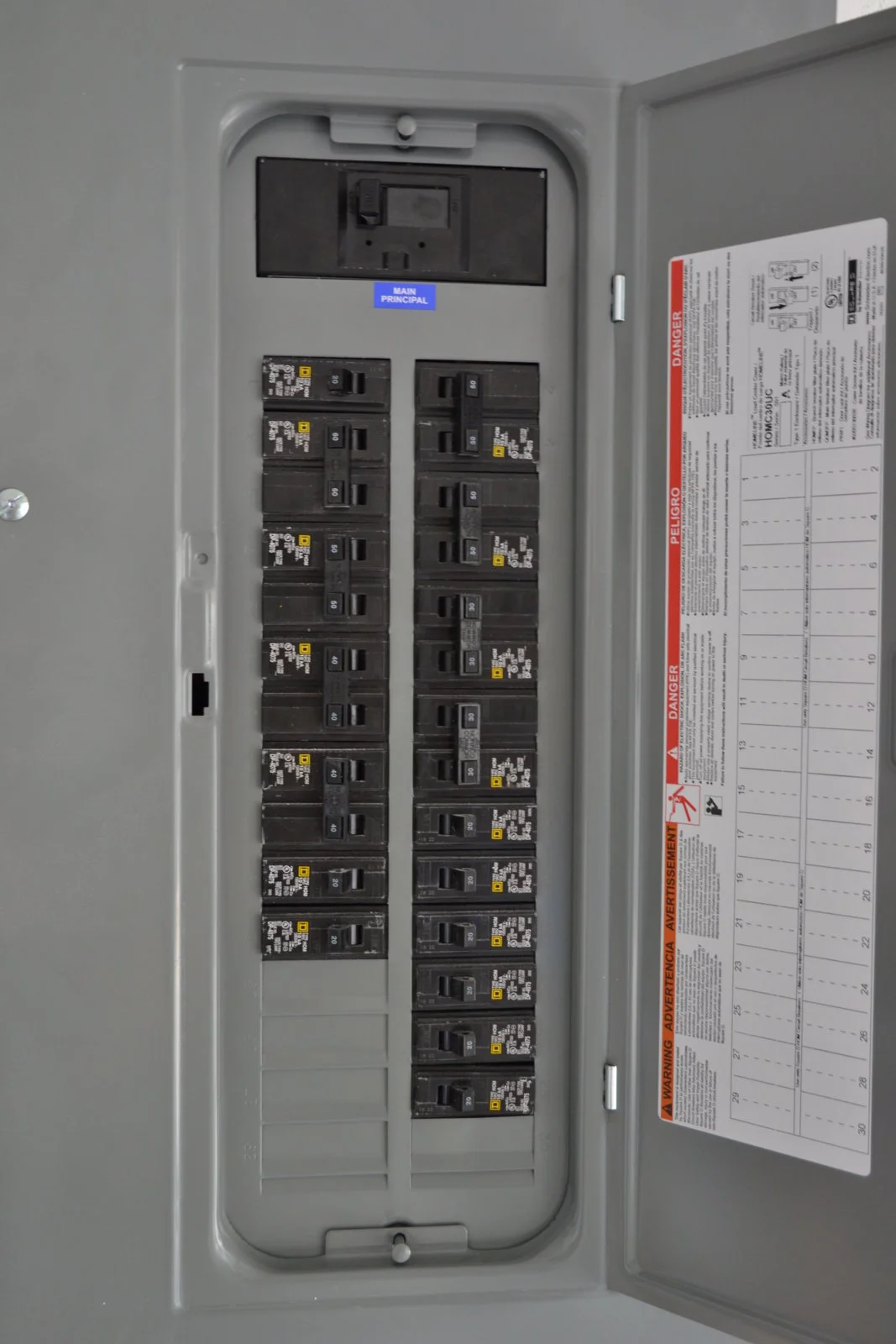

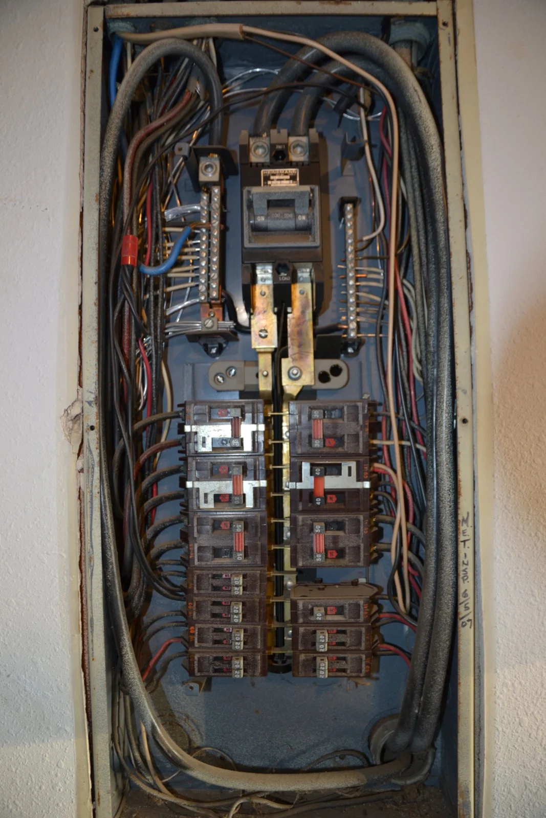

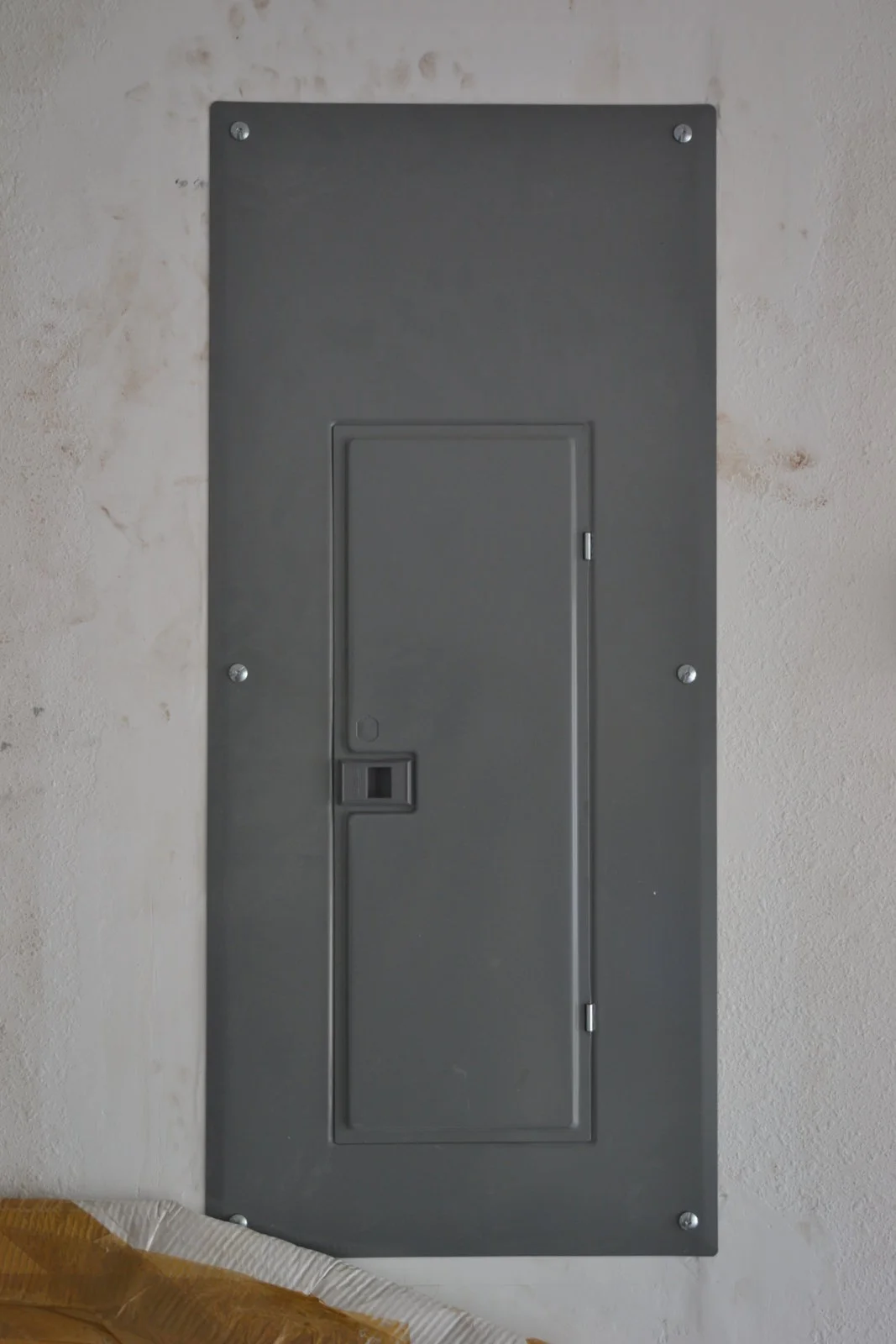

I finally completed a major piece of the puzzle to start working on the car. My new air compressor needed a 220v outlet and there was no more space in the original circuit breaker panel for a 2-pole breaker for my new circuit. Since it would have been as much work to install a sub panel with my drywalled garage, I decided to install an all new circuit breaker panel. I local business quoted me $1300 to install a new panel, so I decided to do it myself. I went legit and got a permit and got the inspection done today.
Before with the original, 20-space panel still in place since 1971:
And after with a new Square D 30-space panel and all new breakers:
