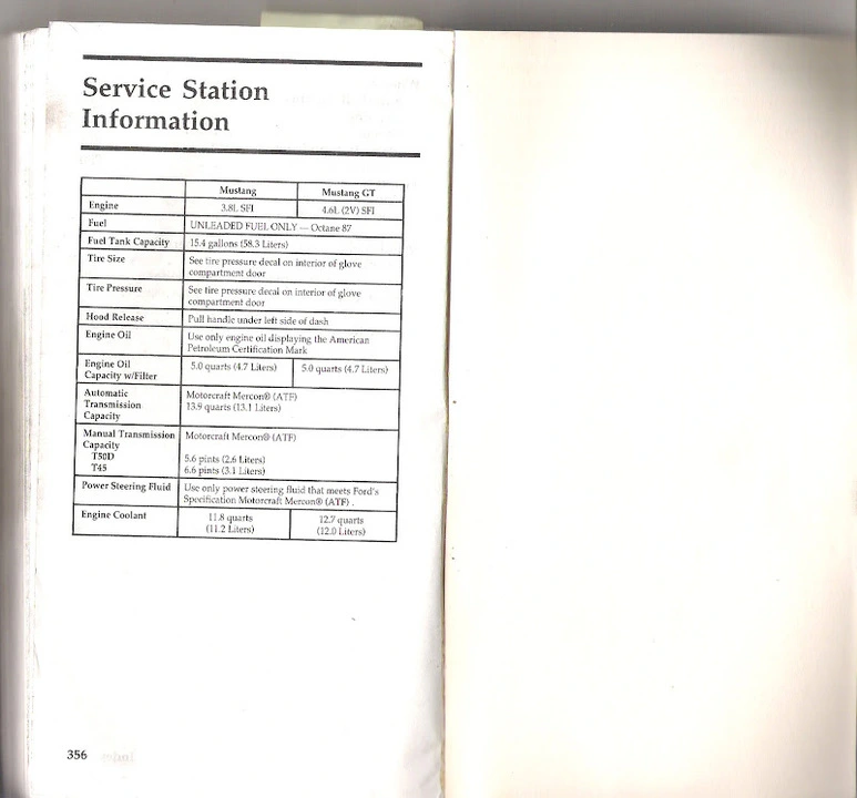

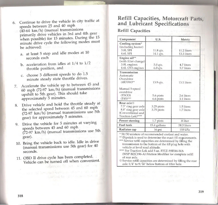

I've joked about this a few times but I had the owners manual out the last night and here it is and double checked to make sure I hadn't imagined it...
Fluids & Capacities, Page 319:
Service Station Information, Page 356:
So there you go... it's 6 quarts. Or 5 quarts :shrug: :crazy:
Good job 1996 Mustang Owner's Manual editors :nonono:
I hate to tell you, but my owners manual states 5 quarts... lol.
I put 6 in anyway.
Everyone SHOULD put 6 in regardless if Romeo (6 quarts) or Windsor (5 quarts). Since the crank isn't dipping into the oil pan like many engines do, an extra quart WILL NOT HURT the motor due to aeration.
