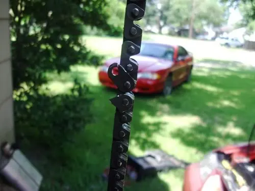

It's always interesting to see other peoples breaks
My old sn95 went from to stripped down after a timing chain BROKE and I slammed some valves on the pistons You'll have to excuse how bad the parts look as I didn't cover the parts after taking the heads off as I knew I was getting work done to them.

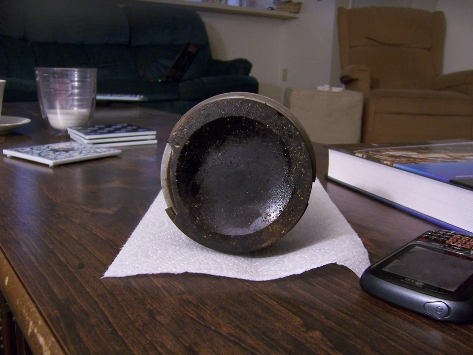

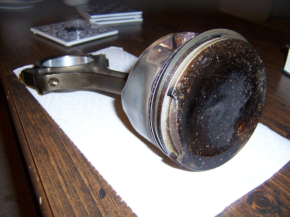

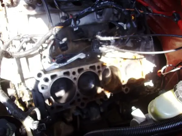

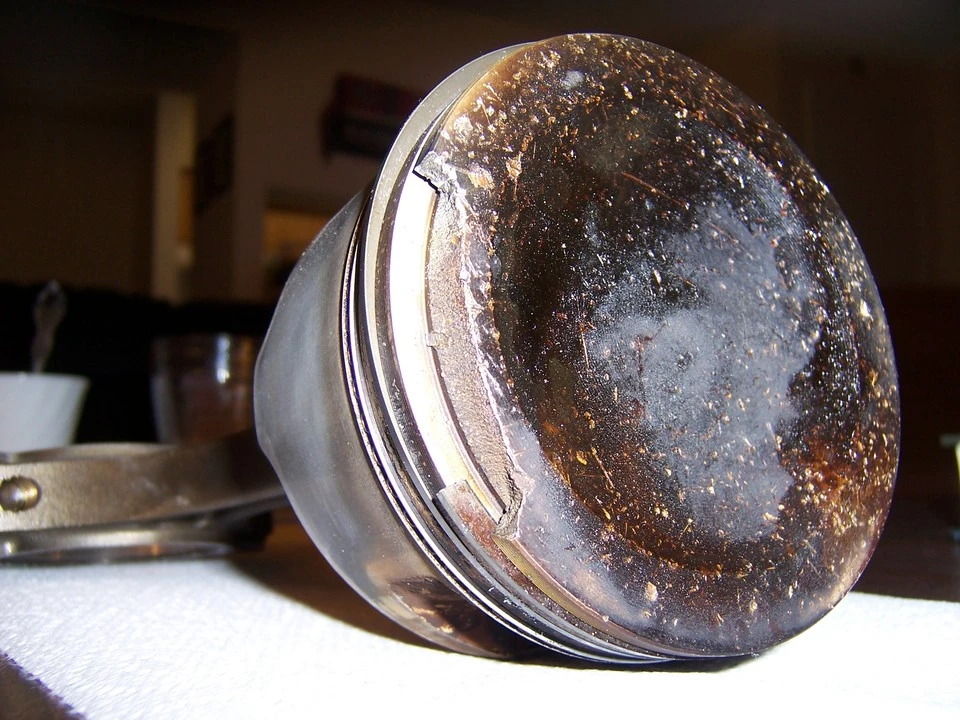

Yea, sucks when something breaks, but it just makes me enjoy it that much more after I get it back together. I've driven my car for less than a week in the last 2 months. I freaking can't wait to get it back on the road (hopefully this upcoming weekend).
As promised:

saw this on fb this morning... that thing is fawked

damn Will, that's crazy.

Hmmm I think she was running LEAN! Sorry Will, lets see some PI pics soon

I bet a $3 bill if you look closely at the ends of the rings you will see the ring from the broken piston is shinier than the others. The stock ring gap is only around 0.010" and they will butt up fast under boost.
Could have been lean, but I think it was timing. After it was tuned, I never once saw it go above 12.2, and that was with no methanol. It was usually 11.5ish with the meth.
Car will hopefully be running this weekend.
I'll look at that. But if you notice, about a third of the top ring on that piston is gone. So I doubt it was touching, lol.
Why would only that one piston look like that, and not all of them?

You usually find the end of the ring still sitting next to the break on a piston like that. Steel rings expand when hot and when they butt up and still get hotter they will break the piston edge out of the way.
Yup, that's exactly how it was.
Would the excessive crankcase pressure from the damaged ring/piston cause a lot of oil to get back through the PCV system? There was a good oil sheen all over everything from the throttle body forward, and I was curious how that happened. Just thought about the PCV system.
Yup, another good test on a running motor is to pull the breather and PCV and if she is chuffing smoke like an oil coal train then a piston is broken somewhere.
