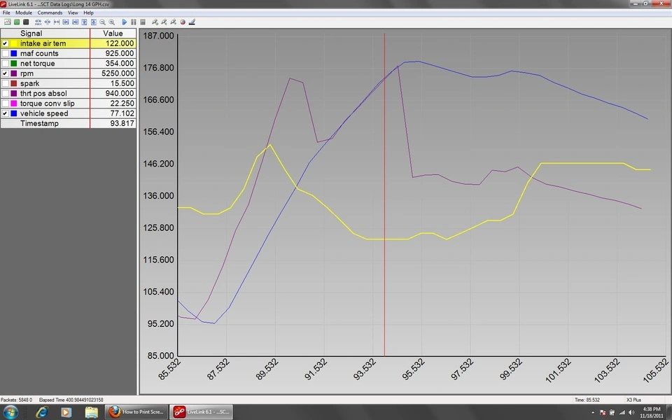

SRT Handz said:
I still think running meth is a waste. Its just another tank you have to monitor and fill up.
Modular2v said:
I fully agree. Hard to replace an IC. I think nitrous would be better than meth!
Still think that? (Click on it to make it bigger.) Yellow is downstream IATs. Purple is RPM. Blue is speed. The scale on the left is the IAT temps.
It was a 1st-2nd gear pull, from a dead stop up to the top of 2nd, about 85 mph. I went WOT (i.e. meth came on) at about the 88.5 second mark.
That was with the blower completely hot. If I sprayed it back to back, the IATs came down into the 90-95 degree range. This is on about 8-8.5 pounds of boost with a non-intercooled hEaton. Plus, I still have another size bigger meth nozzle that I could spray it with, but I don't think it's necessary.
And for reference, without any meth, the IATs were in the 220-230 range. So the meth brought the temps down over 100 degrees. I'd hardly say it's a waste.
Seriously, none of this is meant in a condescending way, but would someone with an intercooled PD blower post up their downstream IATs? I really want to see how they compare.

on a 100 Degree day, my Downstream IATs are no high than 125 when driving around in traffic not boosting hard. When i floor the car the IATs Drop even more because air is passing faster over the intercooler. This is with the blower HOT from driving.
When its cool outside (55-60 degrees). My IAT even go to 100 degrees and lower when just driving around not boosting hard. Boosting hard will make them drop lower.
I see the point of Meth, But my problem with meth is that gotta fill it up kinda like nitrous. The blower is always there anytime i tap the gas with intercooled boost.
I have a air-to-water Intercooler and Honestly I wish it could be air-to-air because with the water system I have to monitor the coolant and the I/C pump. With A2A I wouldnt have to worry about those. But Air-to-water handles business.
IMO, The car already has so many systems to monitor. The less systems you have to worry about, the better.
Alright, so we probably have roughly the same IATs, with you maybe having a slight advantage. BUT, when I'm spraying the meth, I then have an effective octane rating of at least 105. THAT is the advantage of the meth.
my IATs are a little higher than yours (130*) but im also running an eaton which is FAR less effecient than your kb. How much is a meth kit? meth?
Ooops, I meant to include that in my last post, but was in a hurry and forgot it.
I got my meth kit secondhand, brand new for $275. This particular kit is the absolute best quality kit you can buy, and it normally runs about $400.
I use windshield washer fluid as my 'meth'. It is 30% methanol, 70% water and is $2.00 a gallon. 100% methanol can be had for around $5.00 a gallon; I can mix my own 50/50 for less than $3.00/gallon, and mix 65/35 for $3.50/gallon.
The amount I use depends entirely on my driving habits. It only comes on if I'm making over 6 pounds of boost. I got my car back together last Sunday, filled up the 3 gallon meth tank then, and have been driving the crap out of it (i.e. using a LOT of meth), and it still has some left in it.
Under typical conditions, I'll fill up the 3-gallon tank less than once a month. So including track trips, with wiper fluid, I might spend $100 a year on meth.
