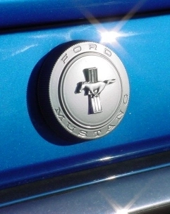

Anymore info you could provide on that new paint system from PPG would be appreciated.
It is brand new. Part of the "Vibrance" line called "Liquid Metal"
It is really nice, but requires a LOT of prep, sanding and patience to apply.
We painted the gas cap (see attachment) as a trial. Pretty cool.

As far as the paint goes, I don't know if I have a crappy monitor, but that doesn't look like polished aluminum to me, it looks like rattlecan silver. Maybe it's just the angle. Did you look at the Alsa website? I'll have to look at the PPG site.
Hummm... How much do you charge for storage??? Before you answer maybe we could work out some kind of cost per mile you drive it package. :rlaugh:
The photo does not do the color justice at all. the reflections are insainly intense. We were looking at it on a sunny day, picked up the suns reflection and almost went blind. Looking in a miror could not have been any more intense.
We were very impressed.
Even though, I will check out the Alsa website.
SN65
Just to be clear, I'm not knocking your color choice, it's just hard to see. Alsa has a ton of stuff that's new since the last time I went to the site. It looks like chrome, just like chrome. They also have a ton of other stuff, like some stuff that would look great on the interior, its called "soft feeling paint", it looks sorta like anodized aluminum. They have all kinds of stuff, and things that you can mix to create different stuff. Really cool site.
