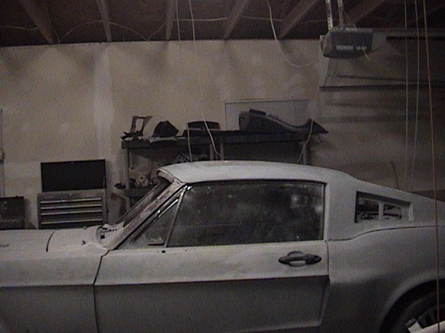

you could do something like my project, this is a convertible with a removeable hardtop.

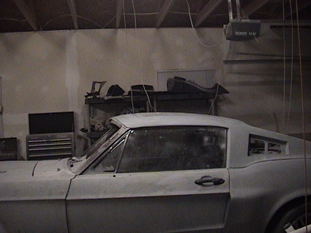

This past weekend (and this week for that matter) Wayne has been concentrating on getting the tail panel, quarters, doors, etc. in primer, while I worked (Saturday only) on getting the inner fender details complete. We are doing everything we can to get the fenders mounted so that Wayne can start on the front fender flares and also complete the detail work on the sides of the car.
That being the case, I worked on finishing off the inner fender wiring details. I drilled the holes in the cowl panels for the door looms and also finished off a few misc details, but I have not finished the inner fender wiring or any of the other details I was hoping to finish this week. I am just a few details away from getting the fenders mounted. Wayne has been very understanding, but I know it must be wearing on his nerves. We are so close to the finish and yet I am the one holding the project up. I am so depressed. I cannot even find the time to take the occasional progress photo.
attachment.php
We set the Maximum Motorsports strut tower brace in place and were trying to picture how we were going to get it to fit under the hood. We discussed a number of alternatives, but all of them seamed to interfere with one device or another. Wayne said, “To bad we can’t run the brace in front of the engine”. I took the brace flipped it over and rotated it 90 degrees and walla, it fit. We just have to remove and re-weld the mounting brackets for the revised positioning.
attachment.php
After we get the doors and fenders mounted, I will concentrate on getting everything associated with the engine complete. If there were only 48 hours in a day, I might be able to spend some time on the car, but I do not see any free time in the immediate future. I have to find replacement personnel, train them, etc…
