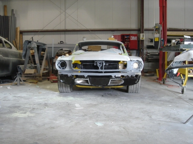

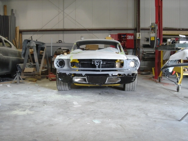

I can't remember, are you giving it a chin spoiler? The way the core support and K-member hang down.....
Looks like you only have 1-1/2"-2" clearance. Is that something hanging below the K-member?
Hi 1320,
The photo is a bit decieving. It was taken at a very low angle. You really have to bend over quite a bit before you see much of the core suppot at all (if any). Here is a photo looking straight into the grill. This is what you would see if you were squatting down about 20 feet in front of the car.
Once the valance is painted Yellow, you will not even notice the core support, even if you were low enough to see it. Although, God save you if this is what you see when the car is doing about 160. :-)
Also, we have about 3.5" of clearance below the K-member.
There is nothing hanging below the K-member. It is probably a bit of snad paper on the ground behind the car.

Well, if you were to put one on there, I wouldn't want it to hang too low, but Bob's right, with the valance painted, the core support should "go away".

Hi TN,
I was actually afraid of this also, but as the tires go up over the speed bump, the K-member goes up and over with them. If you go over the speed bump square, the k-member should not hit. Now the rest of the car is a differnt story. :-)

Did you guys use stock springs or lowering springs? Using the stock suspension components, I would think the car's undercarriage should have about the same amount of ground clearance as a factory '03 Cobra.
Hi E,
We used all Maximum Motorsport components in the car. The front K-member is a graft of the original Cobra piece and the MM tubular item. We have used the 1" lower than stock mounting points for the front "A" arms. All 4 "A" arms (front and back) will be riding just about horizontal (just about a 1/4" downward rake from the inboard mounting point to the ball joints).
This is about as low as you can go without running into suspension geometry problems. We should end up with about 3.5 inches of clearance to the K-member when all is said and done.
Only a guess of course but the 65 body probably weights a little less than the 03, so it might actually ride slightly higher than a stock 03 with same suspension mods would.
That said, I lowered my 97 Cobra by 1.5 front and 1 rear and had hell around some parking lots. Never scraped the K-member but the exhaust was taking a beating as was the front valence. YMMV, and I hope it will.

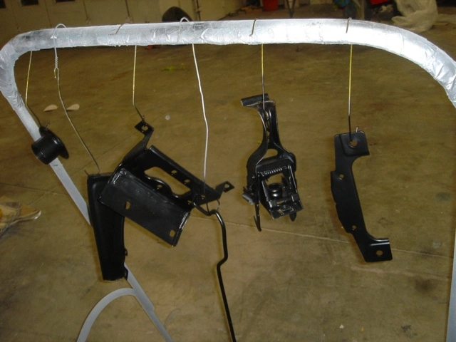

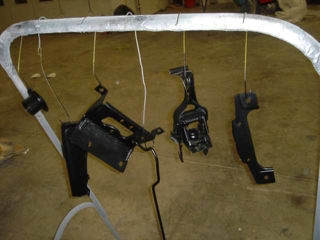

I finished modifying and painting the hood latching hardware.

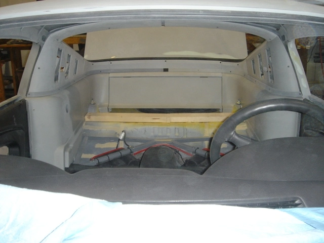

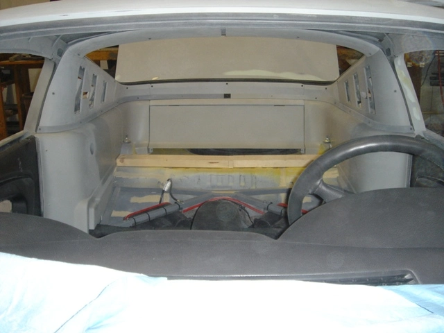

I also preliminarily fit up the rear interior panels. What a pain in the butt. I know that these panels were fit by hand on an assembly line, but gezzz, nothing lines up right. After assembling, disassembling, trimming, relocating tabs and re-drilling mounting holes, I finally ended up with a nice consistent fit. Now I just have to construct the structure for the floor and Wayne can paint the panels. We have to wait on painting these panels until after the floor structure is finished. We don't want to be scratching the newly painted surfaces now do we.
If you look at all the other photos on the site, you can get a real good feel for how the finished interior will look. I think that the blend of 65 and 03 works very well.

Edbert said:
I don't remember from 5,000 pages back but are you doing a rear seat or just panelling it out old-school like?
Hi Edbert,
Gezzz... As I remember it, it was only about 3500 pages back. :-)
No rear seat for this car, although, I could have made that work if I did not add the rear "X" bracing. I am going to panel it out, but a bit differently that it has been done before.
