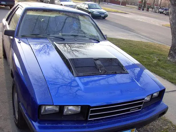

SN65 said:
The color is 2001 dodge dakota briliant blue. It is a saphire blue pearl clearcoat.
WOW that answered a question for me. thats the exact same color i painter my capri a few years back. later i put a different hood on it and couldnt remember the exact color name(knew it had saphire in its name) or what it came off of. so i had them sample the old color to match it up. it came up electric blue. i decided to trust the spectram anilyzer and sprayed the hood-bad match.
thanks for the info!
MustangMatt1966 said:
there ya go :rolleyes:
Yeah, I read that, but it doesn't say anything about the factory weight distribution, and I have no idea what the factory setup was on the original '03 car, which is why I posted what I did.
Ashford, the new hood doesn't appear to match the fenders too well. Or is it just the pic and the lighting? :shrug:
