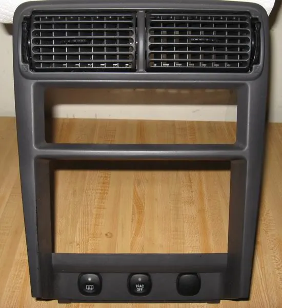

Some progress. Found the 01-04 double-din bezel on eBay:
The double-din opening is 7 9/16" x 4 1/8". Even if I cover the switches I only get 6 1/2", so I'm going to have to get a 7" tablet as opposed to the 10" ones I've been looking at. The current parts list is:

I got it for about $100 of of eBay. LateModelRestoration has the bezel for sale, but it was more expensive AND doesn't have the levers to control how much air blows through the vents. The bezel from eBay came with two switches as well, so if I want to wire them up I can.

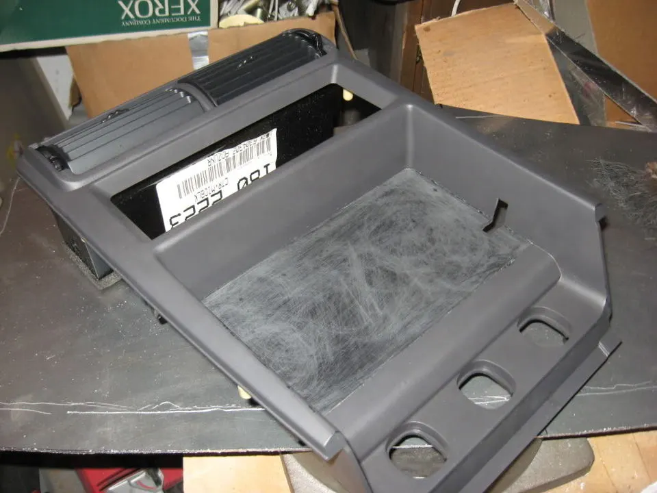

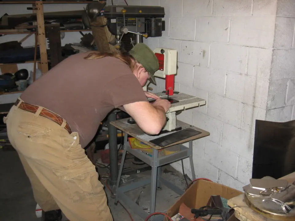

Okay, time for an update. Or past time, considering the work was done last weekend. I needed to fill in the double-din slot in the bezel with black plastic, so there wouldn't be a big hole in my dash when the tablet was removed. Time to ask a favor from my friend Steve, who generously helped me back on my Cobra clone project. Photo time!

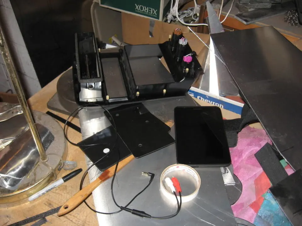

First photo is in Steve's workshop. One bezel, tablet and some of the plastic already cut. The sheets of metal are from a set of armor Steve is building for an upcoming SCA event.
Next is my friend Steve, cutting plastic on his band saw.

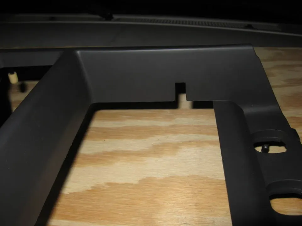

Needed to cut a relief in the side of the bezel for the headphone jack; that's how the tunes will get from the tablet to the amp in the dash.
The plastic sheet has been glued to the back of the bezel, but there's still a final piece to add.

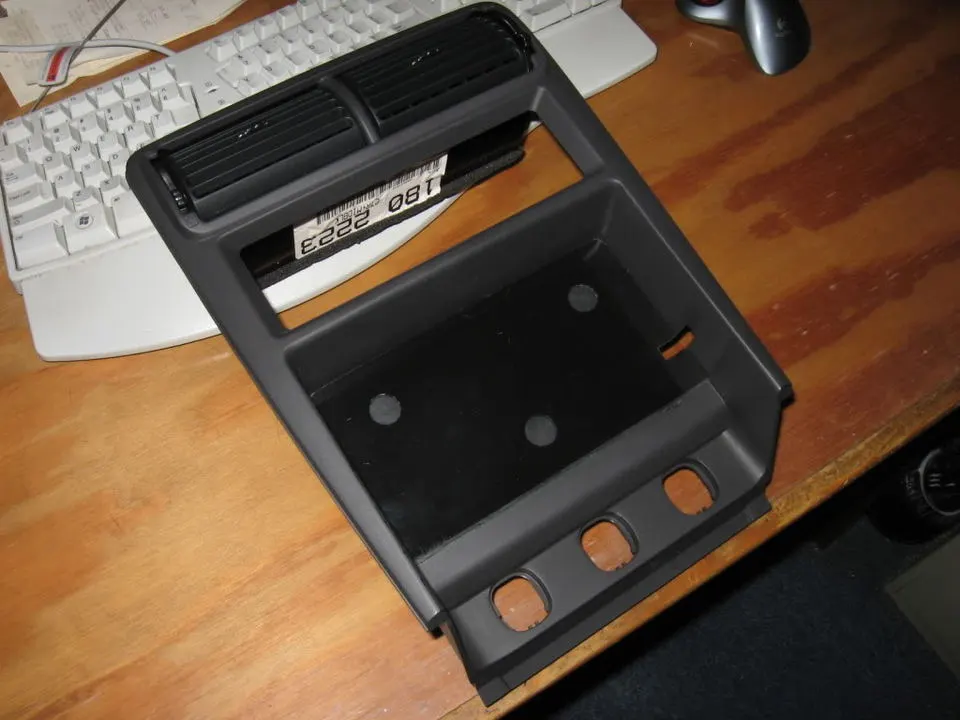

And...complete. One polished black plastic cover. The three holes are for the small magnets I bought to hold the tablet to the dash. They're designed to hold cell phones to the dash of a car, so they shouldn't interfere with the tablet.
The magnets hold on to metal discs you stick to the back of whatever you want to hold in place. I used these, they're a LOT smaller than the Amazon photo implied:

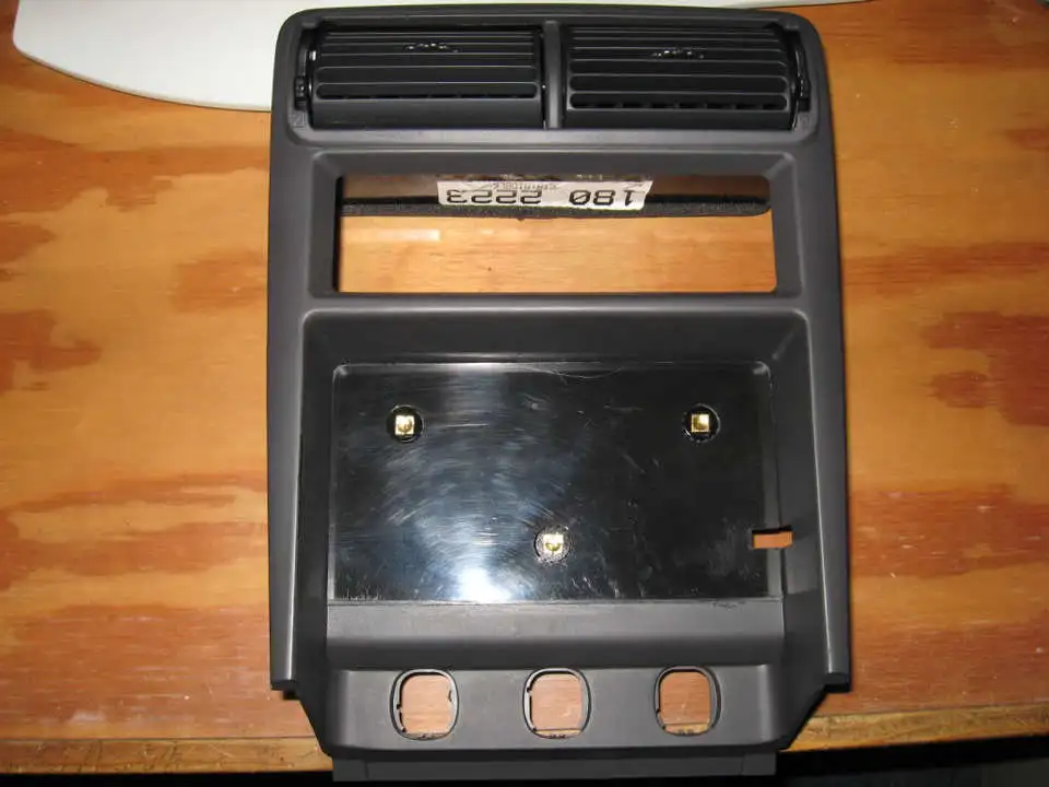

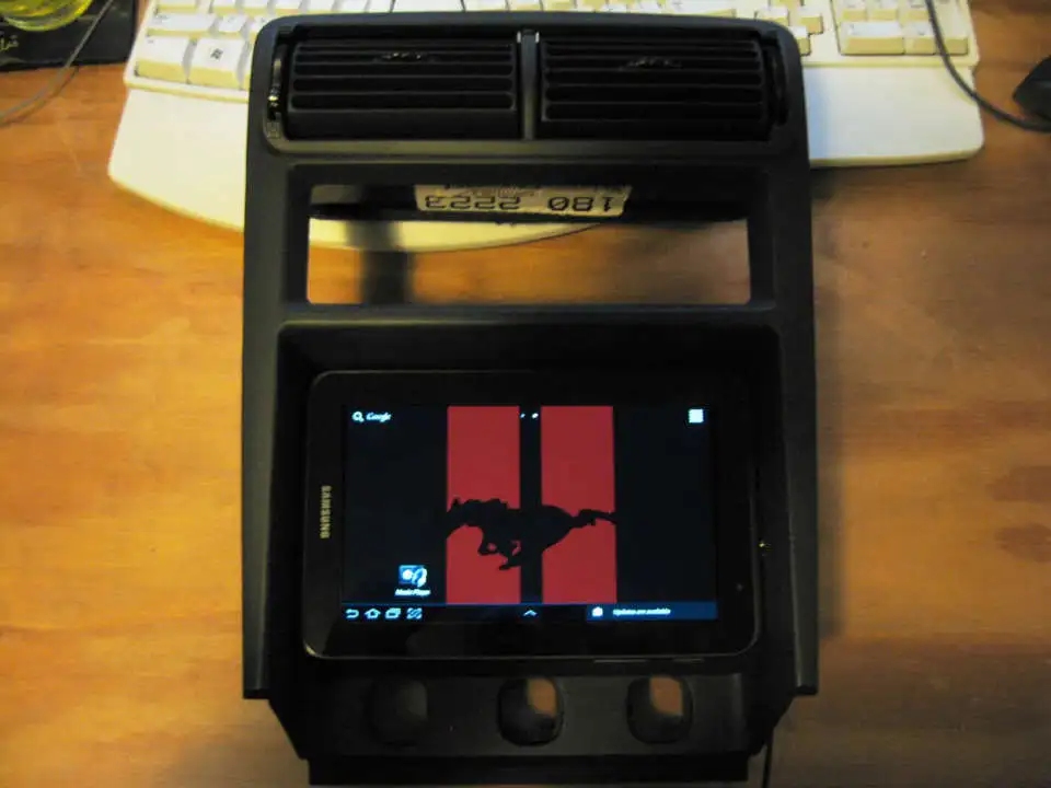

More progress. The tablet is now attached to the bezel, and I'm on target to install this in my Cobra clone on Saturday. First pic is the bezel with the neodymium magnets installed. Neodymium magnets have a strong yet small magnetic field - they'll hold a metal disc really well, but the magnet won't affect the electronics.
This is the back of the tablet. The discs in the upper corners and bottom middle are what the neodymium magnets hold on to. The "disc" in the lower left is the camera lens.

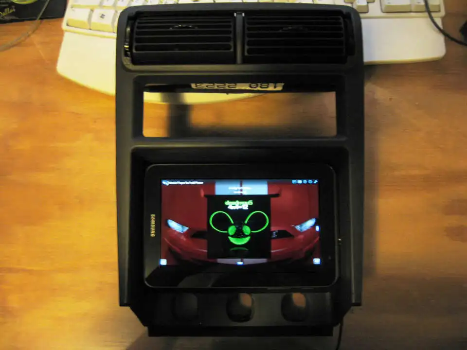

The tablet is mounted in the bezel in this next pic, sitting at the Android hone screen. The one icon in the lower-left is for the music player. Had to mess with this and the next image in Photoshop; camera flash wiped out the tablet screen, but no flash was too dark. So I brightened everything but the tablet screen.
Last, the media player running and showing an album cover for the mp3 it's playing.
