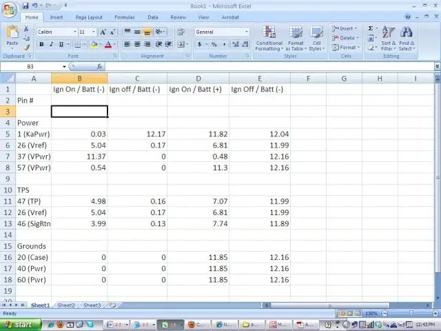

Here are some numbers that I found somewhat concerning. I tested for continuity for pins 37 and 57 to the EEC relay. 37 is good but 57 is not. I am also told that 5v to pin 46 is an issue as well. Thoughts?

The orange/white wire is supposed to be 5 volts for the sensors. Pin 46 is the signal ground for the same sensors. No 5 volts, the sensors don't work. No signal ground, the sensors don't work.

Gotcha. So pin 26 is working fine as is pin 46. So would the issue with the continuity on pin 57 really cause all these problems?
I know that the line for pin 57 splices into 37 in the harness somewhere. Since I am not showing continuity from pin 57 to the EEC relay (37 is just fine), would it be a bad idea to just solder a jumper between 57 and 37 on the EEC and see how it behaves before I start tearing into the harness to look for a splice that may or may not be bad?

The break in theharness is probably at the junction where 37 & 57 are soldered to the fuse link. The fuse link is back by the starter solenoid, and is a blue wire that comes off the starter solenoid.
