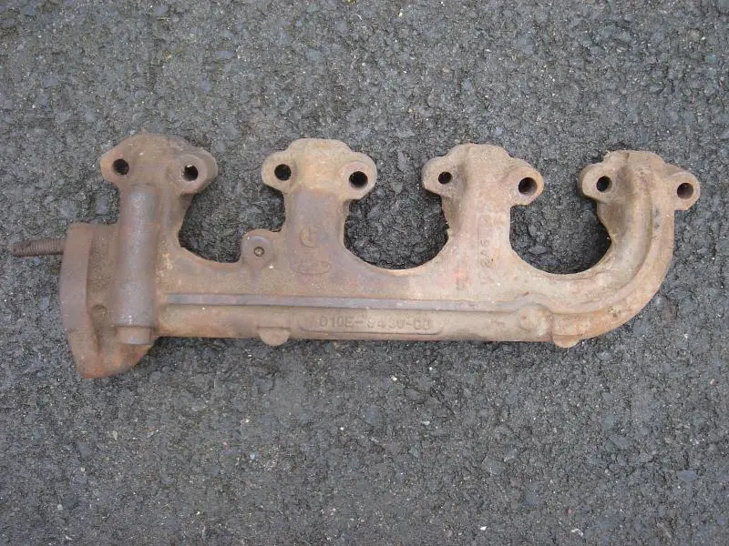

D.Hearne said:
That long right side is from a Mustang II.
Yeah, the RH match to your LH would be this one:
