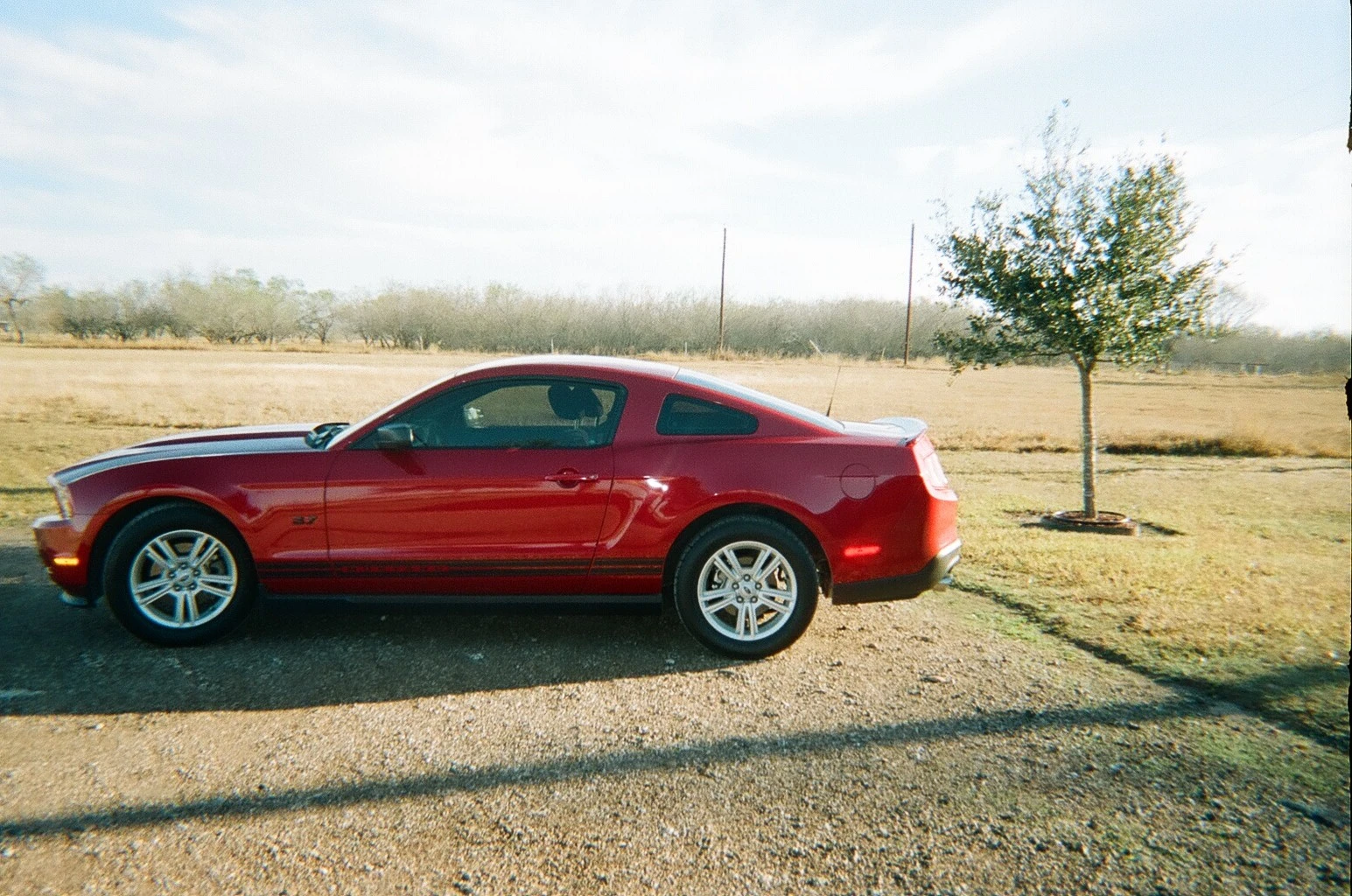

Husky44 the stripes I used was a Ford Direct part. I could not get the stripes from the factory because of the Glass Roof, so I had to order them and have them installed at the dealer.
