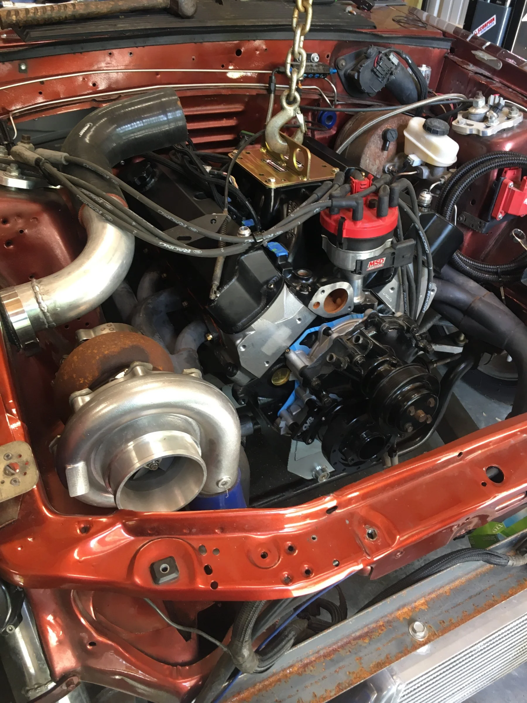

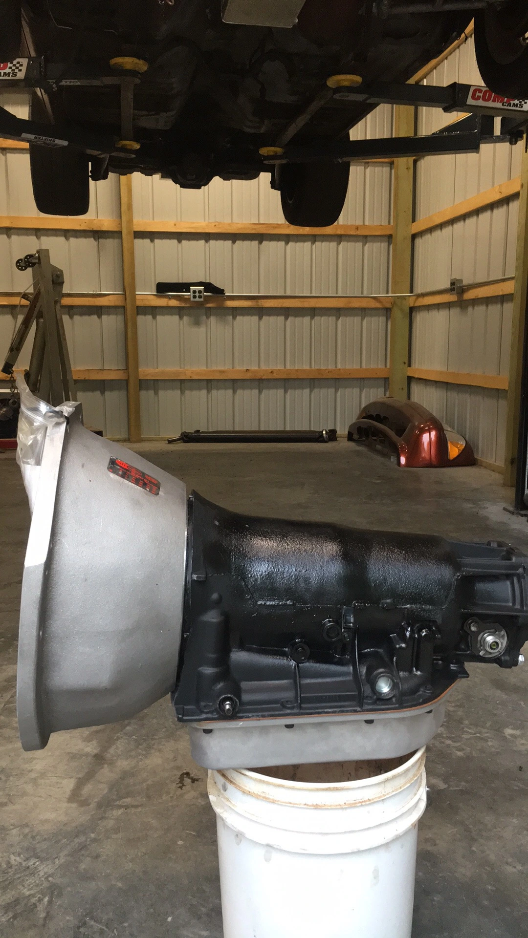

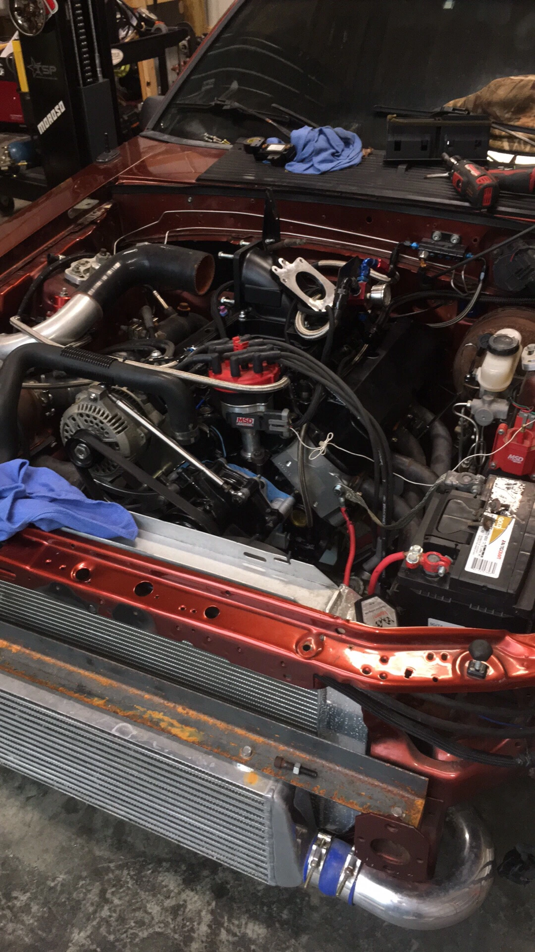

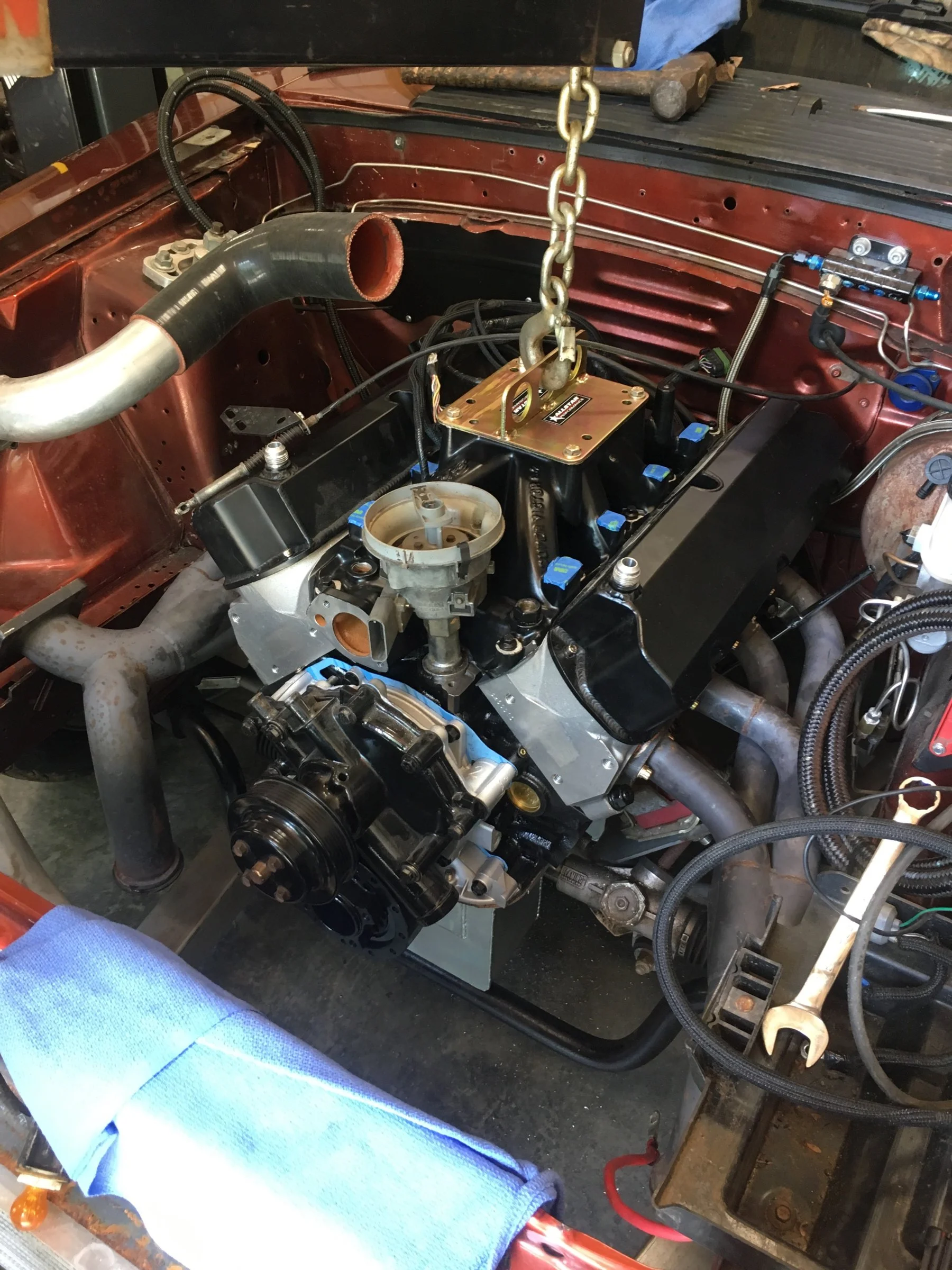

for anyone who's been keeping track of my build I've gotten the new motor setup in. I'm looking to get a new throttle body but unsure of the size to get. My charge pipe from the turbo is 2.5" which equates to 63-64mm my old combo I had a 75mm on it. Wondering if I should bump up to an 80mm. Any insight would be appreciated here's a few pics.
