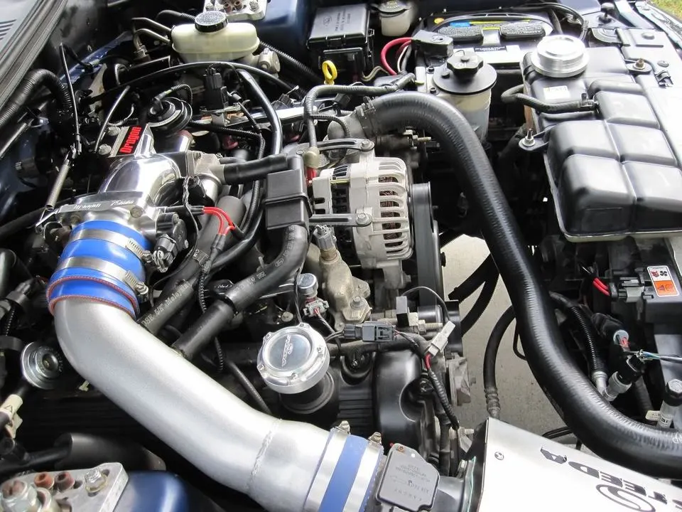

My car came with a Dragon 75mm TB/Plenum. Looks nice :)
Mods/numbers in sig.
