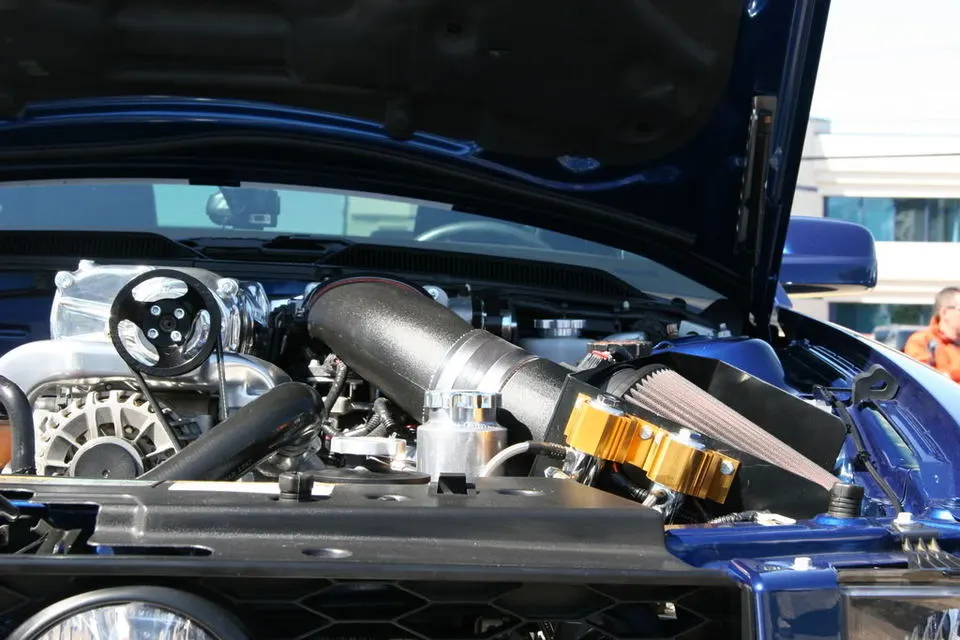

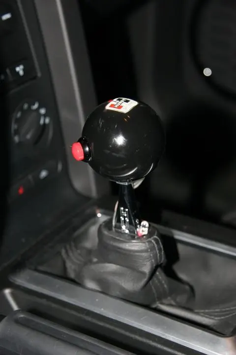

Line locks are way too much fun! I installed Granatelli line locks a few weeks ago. They're gold anodized and I mounted them on my CAI shroud.
I also installed a sidewinder shift ball on my Hurst S/T shifter. The button placement is perfect for controlling the line locks. The red LED at the top of the shift boot indicates when the solenoids are powered. I'll probably move it to a permanent location in the dash or console but haven't decided where just yet.

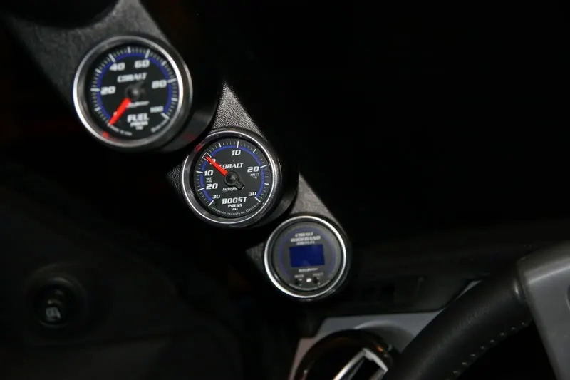

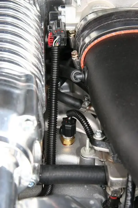

I went with the Whipple HO kit as I liked the old school look of it compared to the Saleen which is totally buried. The Whipple also comes with the dual fuel pumps. For gauges I went with Autometer Cobalt in an Autometer triple A-Pillar pod. I'm not thrilled with the finish on the pod and plan to change it out to an SOS triple pod. At the time I couldn't find an SOS pod with all three egg crates lined up perfectly. I went vac/boost, wideband AFR, and fuel pressure. The other mods I did in conjunction with the S/C was an air/oil separator to keep blowby oil from fouling the intercooler exchanger, and I relocated the intake air temperature sensor from the stock MAF location to a dedicated sensor in the #6 intake runner.
If you have any mechanical ability at all you can do the install yourself - it's tedious but not difficult and will save you a bunch of cash. You can also ensure that everything is done right as there's lot's of places for shortcuts (not soldering the harness extensions for example).
IAT Sensor relocate:
